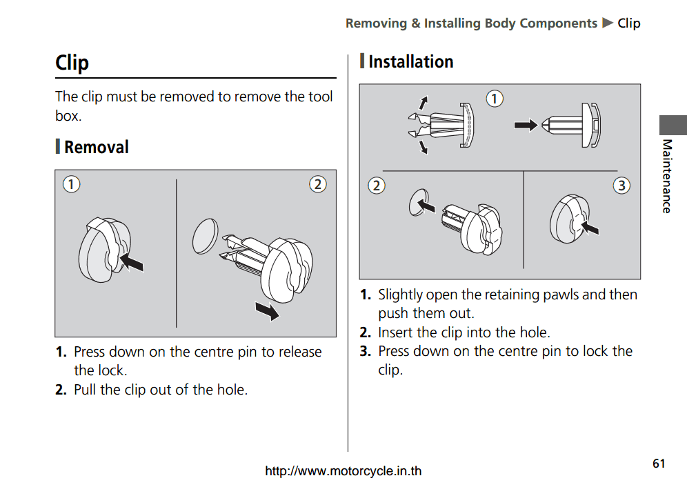

So what its the trick to getting the battery door open?
I can see the nice little retaining plug with its locking button pushed nice and flush. From working on trim on the car, I know how these things work (or at least think I do). How do I get that plug out without trashing the retaining plug?

Thanks! Got it open and can now install battery charging wires that I am sure to need over the next few months. I would prefer to do the task when the weather is above freezing.
My experience with this sort of clip is that you push it to make it flush and the wings separate and retain the parts. A two-step clip is actually pretty clever. (It should be noted that I am easily entertained by this sort of thing.)

Re: So what its the trick to getting the battery door open?
Now Chrome is rendering the illustration just fine. Odd, but better.

I have the same question. I see there was a picture, but I can't see it. If someone still has the picture can you re-post it?
Push the center of the pin in (I'll call this the "center rod"). This will release the "wings" and let you pull out the pin.
To re-install, push the center rod back out so that it protrudes from the face. Re-install the clip, and push the center rod back to flush.
The two-step center rod lock is very clever. If you have your manual, look on page 57.

Thank you so much!!! While going through some threads I found some posts about the manual on sell.com. I found one for $30 and I ordered it tonight. Thank you also for posting the page number. I will try this tomorrow. I really didn't want to wait til the manual got here.

GeorgeSK wrote:Push the center of the pin in (I'll call this the "center rod"). This will release the "wings" and let you pull out the pin.
It is a fantastic piece of engineering
Uploaded GN2's image here -- it took over a minute to load on my machine for some reason. Should pull up immediately on the forum's hosting.
Thanks, Maddiedog. Not sure why gn2's pic went AWOL. It will be nice to have the more permanent record.
