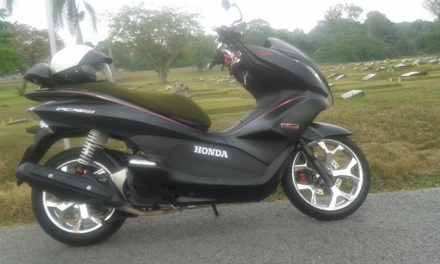

maddiedog wrote:They look lightweight too. Any pictures of them on the PCX?
Here is the pic,need some modification to the bush/sleeve between the bearings at the front wheel and between the axis and the fork,rear wheel fits perfectly.

Are those white or chrome? 14's? What tire sizes, stock?

Its chrome 14 inch wheels and I am using irc wings series 100 70 14 front,120 70 14 rear.Without any modification .
