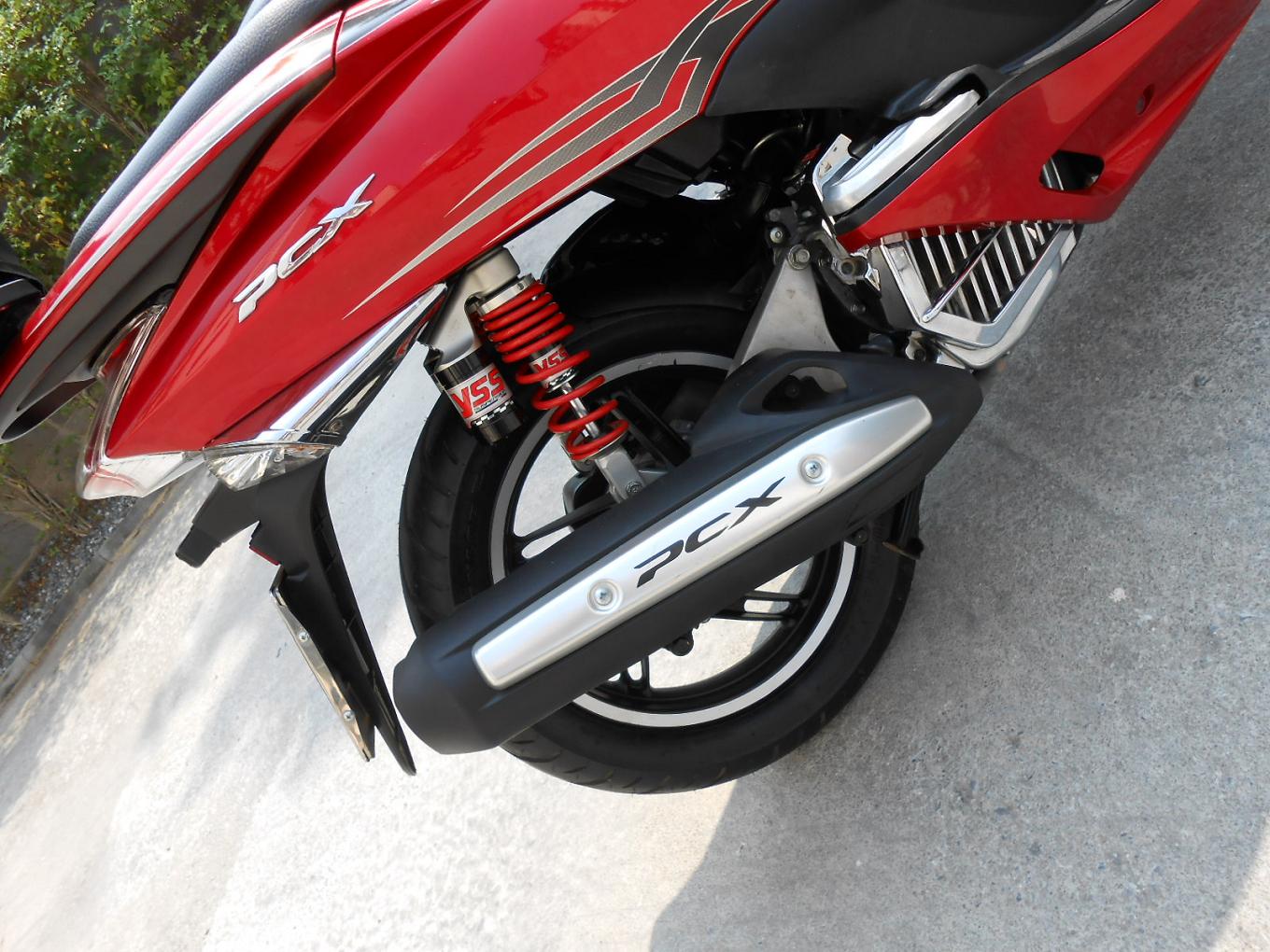

yeh, good....improve the ride....
circa 80 gbp here...
pcx - 2 005.jpg (259.4 KiB) Viewed 12762 times

is it softer or harder than the original?
hatari
Posts: 169
Location: Hua Hin, Thailand
Re: YSS shock absorvers
Post by hatari »
henrydjunaedi wrote:is it softer or harder than the original?
HARDER !

not sure if i would say harder. the original shocks didnt work worth a shit for me. the YSS actually absorb shocks, dips and bumps well unlike the stock shocks. i would say $200 is a decent price in the US. dont get caught up comparing to the price people are buying them for in thailand where they are made and most everything is cheaper.

it depends on your weight. keep in mind that you need to buy the proper ones for your weight. if you are huge and heavy, the ones in the hatari pic would probably still bottom out. if you buy the right ones, they shoulndt bottom out except under extreme circumstances.
i am about 85-90kg with riding gear and carry another 5kg of gear often. they the YSS shocks in the hatari pic have never bottomed out on me, but it felt like the stock shocks did fairly often on the same streets. those stock shocks suck the big one!

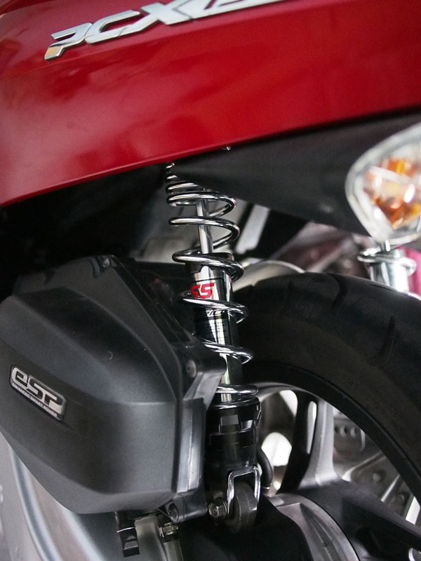

I just install a pair of YSS Hybrid type (much cheaper than G Series with separate tube shown before) on my 150cc PCX, it cost around $80 here. I found that the YSS Hybrid have much better rebound and can absorb the road bump better than original shock from Honda especially when I have to ride PCX together with my wife. If you have to install it yourself you need to stripped almost all the half of PCX plastic panel and it takes quite sometimes to find the right settings based on your road condition and your weight since the manual provided is very minimal and no special tool for adjusting given inside the package. You can adjust manually though.
IMG]http://i628.photobucket.com/albums/uu10 ... a82b9b.jpg[/IMG]

My reply seems broken here the image of YSS Hybrid on my PCX

What was the yss part number?

The marking in packaging printed as follow:
YSS V-Series
TB220-315P-05-11-XD
Hybrid-S220 PCX Chrome/Chrome
220 is the shock type number and 315 is the shock size in mm
and Chrome/Chrome being the color of the shock,
other color option being Black-Red but I choose Chrome
because from my previous experience on other scooter with
red painted shock absorber the paint will easily get scratch
