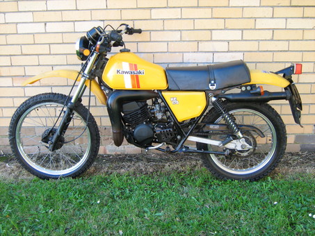

You had a ke175. Probably my favourite bike ever!!! Was it a b3? In green?
Re: Cheap alarm
I loved my KE175, it was yellow but dunno if it was a b3. I had it in the early 80's, great bike and great fun to ride.You had a ke175. Probably my favourite bike ever!!! Was it a b3? In green?

That was the model after mine. Nice bike

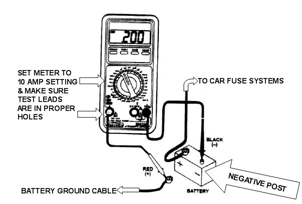

It will still use a bit. Otherwise it wouldn't arm when the remote is pressed. Probably not as much as when it's armed though. You could check the draw by using a multimeter on the amp setting in series over the power lead.

Diagram of how to check current draw. Please note if your not sure how to do this ask a competent mechanic or auto electrician.
