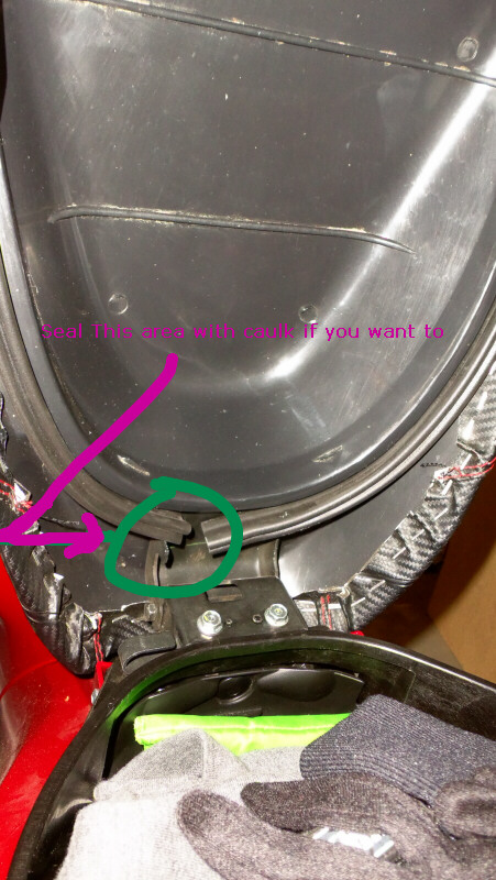

It only took me a minute to pull my original seal off and put it on the new seat. It should fit. If there is an open area make sure it is at the hinge. You can use caulk in the small amount of opening not covered.

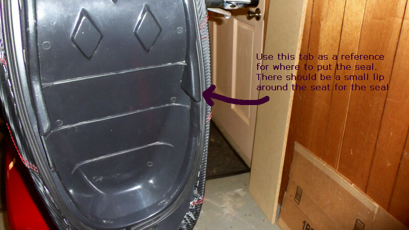

my factory Honda seat had a groove that the seal fit into. My replacement seat does not. I put the factory seal on the seat with some new 2 way tape, but when I close it the seal rolls out of place.
Live each day like it's your last, and one day you will be right
Re: replacement seat seal
You may not be able to get a seal for the aftermarket seat. The moldings are set to either accept a foam seal strip or not to. What shop did you order it from?

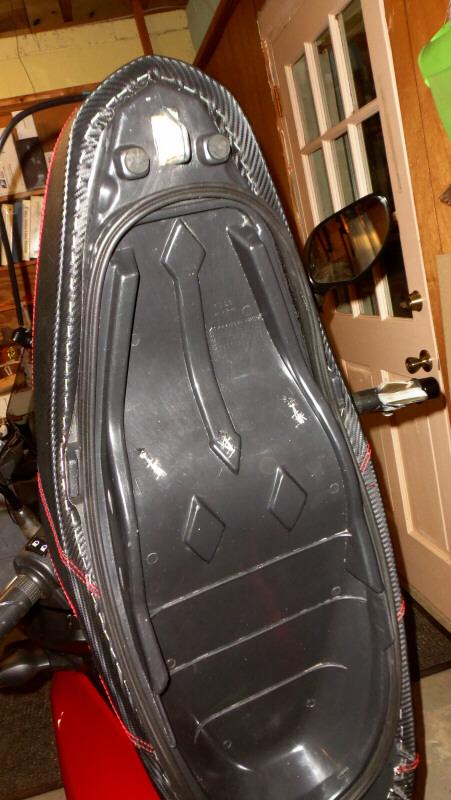

OK, here is where you should put the seal.

got it to fit, had trim some of the seat material away. My try a different seal material , like foam. What I am experiencing is that when I close the seat with the Honda one, it rolls out to the side because there is nothing to hold it in place. As for the seat ,I got it from biker bitz. it is the same seat base shown in the pictures, it had the same number as the same seat from powerbypcx. Thanks for the help, I will get it figured out.
