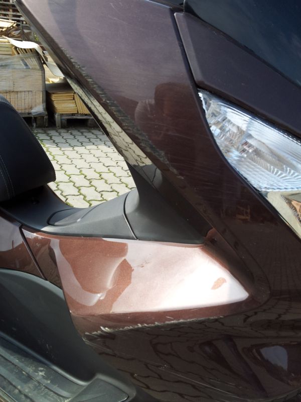

Hi guys, could you help me please? I fell down with my new PCX 125 (version 2014) and scratched it on right side. Side cover and floor step are cracked and I would like to repair them. But there is a problem... I easily removed side cover (which is in color of my scooter), but I can not find a way how to remove black floor step. I spent almost 2 hours under scooter, but I was not successful.
Could anyone help me with this? Can I ask you send me a pictures from repair manual with procedure how to put floor step panel down? Thank you very much!

- This I have to repar too...
- IMG_20140909_103626.jpg (129.39 KiB) Viewed 7480 times
- This I have to repair...
- IMG_20140909_103813.jpg (134.45 KiB) Viewed 7480 times

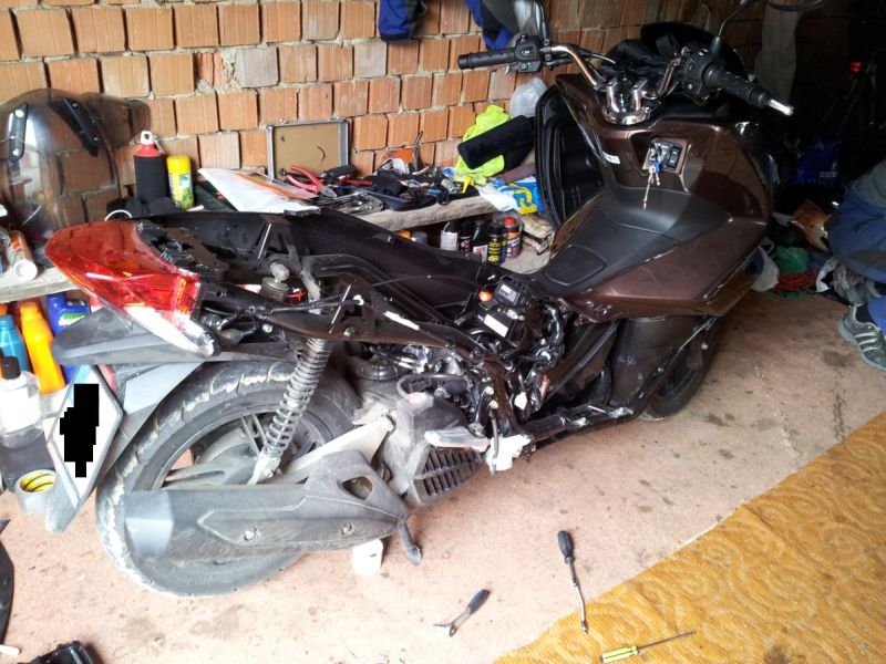

Hi guys, I am from Czech Republic, my Honda PCX 125 is model which started sell in the middle of 2014. Some distributors call it model 2014 or version 3. Now I checked websites of my distributor and he also renamed it to model 2015
Scooter in brown color you can see on this websites: http://www.honda.cz/motorcycles/range/s ... tions.html or http://www.motorkari.cz/clanky/redakcni ... 28370.html
IMHO the brown color is the most nice color of this scooter :-) I was choosing between brown, white and silver. And the brown is simply the best.
Thank you for sending manual how to remove body panels. I already put them down after 3 hour work before you sent it. It was sometime quite difficult but it is possible to make it without manual.
Below I am sending you picture after work. Tomorrow I am going to assembly it, plastic parts should be already welded.
- After 3 hours of work.
- IMG_20140925_115151.jpg (157.82 KiB) Viewed 7448 times

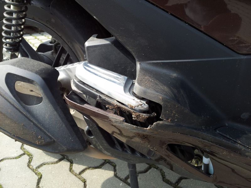

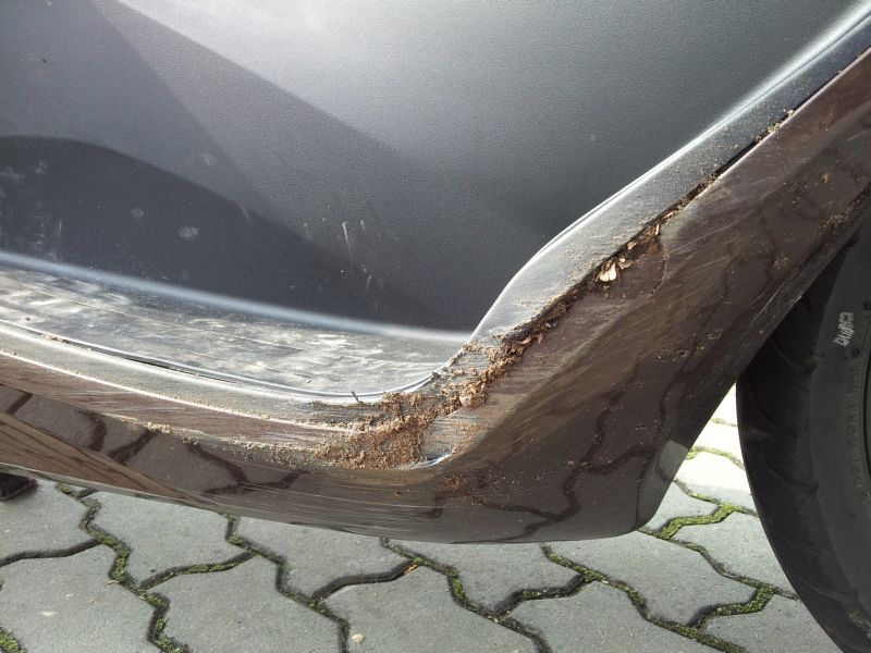

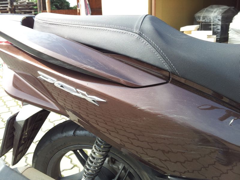

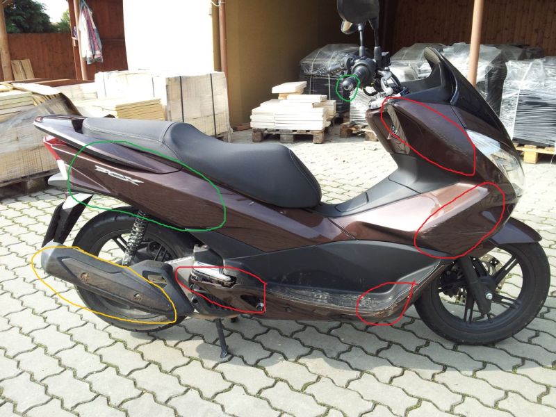

I have a guy who weld it for me for approx 600 CZK (it is about 27,9 USD or 21,8 EUR). New panels cost 2 000-3 000 CZK/piece (93 USD-139,5 USD or 72,7 EUR - 109,1 EUR). In authorized service they do not repairing it, they are only changing it for new one. My distributor told me that approx price of parts which will be changed (righ side cover, right floor step, right body cover, right front cover) will cost 10 000 CZK (work included), it is about 465,1 USD or 363,6 EUR
My first thought was: "Are you crazy???". So i decided to repair it by myself. Below I attached pictures of scooter after crash. Red marked are parts which are very scratched and they need new paint (and weld in case of side cover and floor step). Green marked are parts which are not so much scratched and they can be repaired by pollishing this parts. Yellow marked is cover of muffler which is not important to repair.
If you want to dissassembly panels in the middle of scooter, you have to start from rear:
1. side cover
2. grab rail cover
3. grab rail
4. seat
5. luggage box
6. body cover
7. floor step

- After crash.
- IMG_20140909_103609.jpg (106.62 KiB) Viewed 7447 times
- Detail 4
- IMG_20140909_103813.jpg (139.08 KiB) Viewed 7447 times
- Detail 3
- IMG_20140909_103655.jpg (149.34 KiB) Viewed 7447 times
- Detail 2
- IMG_20140909_103636.jpg (109.19 KiB) Viewed 7447 times
- Detail 1
- IMG_20140909_103626.jpg (129.39 KiB) Viewed 7447 times
