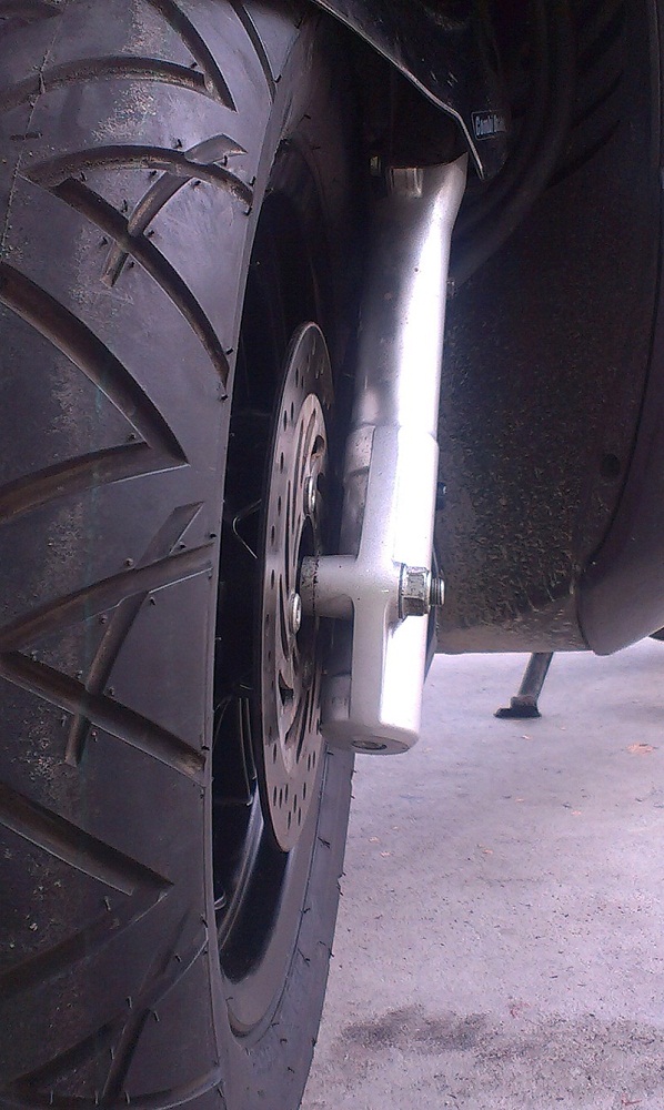

I am in Thailand and changed my wheels to 13" as they are the only after market ones I could find. The reason for wanting to change the tires is that it is part of a plan to get more suspension. Last week while driving at night down a very dark road I ran over a large pothole, so large that my back box broke away and end 50 yards across the road and my back wheel was destroyed. I am very lucky to still be here if I had fallen off I would have been run over. I am doing the modification to stay alive on the crazy roads in Thailand. I am a big heavy man and the standard setup isn't good enough. Don't care about losing speed just about dying.dasshreddar wrote:Welcome, where are you located? and where did you get your 13's?
I think the biggest 13 tire you can fit is a 130-60-13...a 110-70 series may just be too tall and wide for the stock forks/aftermarket wheel.
try an aftermarket fork???
or you can run a 120-70-14 on the front(stock rim) and trim the "tire hairs", like I did.![]()
powerbypcx sells 13's here is a pic of a 130-60-13.
I decided I needed something to handle the very bad roads. The back wheel is 13" and fitted with a 130/70-13 which is the same height as the standard 14" but with a lot more tire depth to help with the bumps. I have also fitted a set of YSS Z series shocks at the back. The back side modification was no problem at all and went on easy.
Now to the front the smallest 13" tire I can get anywhere in Thailand is 110/90-13. When this tire is fitted to the wheel the tire is binding with the inside of the forks at the top. I have taken off the wheel and front mud guard and measured between the forks. at the axle point the cap is almost 120mm but at the top it is only 105mm. So I guess hence my problem. Somebody mentioned grinding the forks on another forum which is very stupid and dangeruos.
I could fit the stock wheel and a 120/70-14 tire but I already have the 13" set and would really like to fit it. I have enclosed a picture of my problem. Are there any aftermarket forks around which could take the 110/70-13 tire.

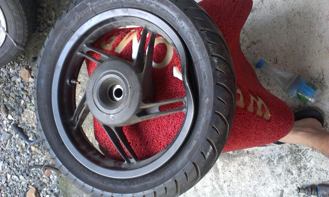

Re: Fitting 13" wheels and wide tires on PCX 150
This time with pictures

Having now had time to think I guess I have two options with changing the front forks.ruddick wrote:I am in Thailand and changed my wheels to 13" as they are the only after market ones I could find. The reason for wanting to change the tires is that it is part of a plan to get more suspension. Last week while driving at night down a very dark road I ran over a large pothole, so large that my back box broke away and end 50 yards across the road and my back wheel was destroyed. I am very lucky to still be here if I had fallen off I would have been run over. I am doing the modification to stay alive on the crazy roads in Thailand. I am a big heavy man and the standard setup isn't good enough. Don't care about losing speed just about dying.dasshreddar wrote:Welcome, where are you located? and where did you get your 13's?

1. Stay with the standard 14" wheel and fit the 120/70-14 tire.
2. Change the 110 tire as it is a no go for the 130/60-13 tire.
I have also decided not to try and do anything more myself but to take the scooter along with the 13" wheel to the PCX shop and ask them to sort it out.
Thanks for the mostly helpful comments.

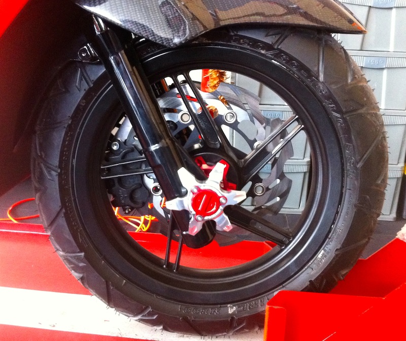

The PCX wheel and tire change problems are now behind us with the help of the very nice guys at X-Speed Bangkok. The IRC 110/90-13 was a no go and as suggested on this forum we ended up fitting a IRC MB99 130/60-13 on the front and an MB99 130/70-13 on the back. Also replaced the rear shocks with YSS Z series 310mm XXL adjustable gas shocks. Once the tire pressures were set the bike ran like a dream.
Only problem with fitting the 130/60-13 on the front was that a very small amount of grinding was required to ensure the tire didn't rub on the inside of the forks.
