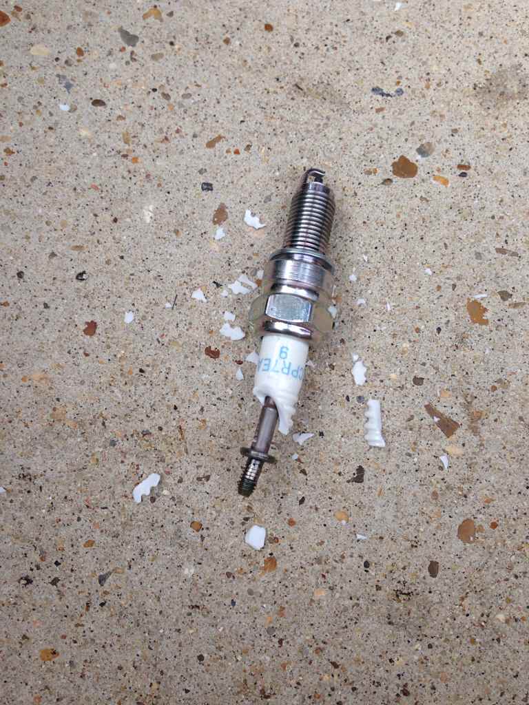

I am beyond irritated right now. I broken the new spark plug
And fouled the old one now. Now the old one, I could still ride the bike, but there are noticeable misfires

Relax, breathe, relax. spark plugs are... cheap... be happy you broke the top half and not stripped the soft aluminum engine head.
It is a tight fit to get at the plug opening, but if you go slow, relax, it will work.
Good luck on your next spark plug install adventure.

I bought this one for $7 at the dealership. Since it was 6pm when I decided I needed to do this again but didnt want to throw away more money, I went to Advance Auto Parts(who originally said they were out of stock along with Autozone and Oreillys) and they ordered me one that I will pick up tomorrow for $3.03. Same exact plug(NGK CPR7EA-9) just doesnt have honda logo on it. Getting it tomorrow but scooter still technically runs more.
I think that the stalling problem is because of spark plug though. The old one was almost solid black charred. I put it back in and now it stalls way more but as long as I ease the throttle up I can still reach full throttle speeds. It stalled on me at stoplight and I just pushed electric start again. Simple. But I do want to replace it soon.

Got spark plug changed out. Talked to guy at advance auto parts who happened to be a motorcycle mechanic and he told me the right way to change it. I was accidentally over tightening but didn't damage anything thankfully.
