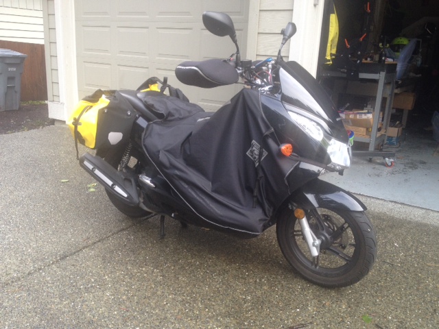

I'll add some better pictures. My gloves are sitting in front of the speedometer. The black cloth in front of the bars is a Tucano Urbano apron. I live in Seattle, and I leave it on for warmth and to keep dry.

Ya, it was that apron I was wondering about. Thanks. Not that I would need one in Thailand, but I will look forward to seeing the picture.JLP wrote:The black cloth in front of the bars is a Tucano Urbano apron. I live in Seattle, and I leave it on for warmth and to keep dry.

Anyway, here I am all set up for my first road trip with the PCX. I'm doing about 700 miles round trip from outside Seattle to a friend's house southwest of Portland. I suspect many wet hours, but I honestly think I'm all set.
Should be fun. I'm rolling tomorrow.

Oh, and I just moved the hump back a little less than an inch with the highly technical "drill a couple other holes" mod. It is perfect for me. And free. Free is nice. SInce I live where it rains all the time, I sealed up all the holes with silicone while I was at it. Nice.
