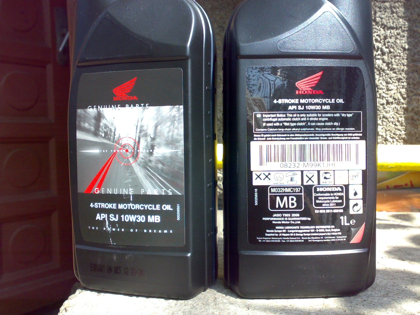

I was to my dealer for 1000 km (600 mi) first check. I payed only the cost of the motor oil; they told me that the Manhour is FOC (Free Of Charge) from Honda.
The type of motor oil was ordered by myself to dealer one month before. (The price was 12 euro/liter). I wanted and I asked to the dealer to bring what Honda recommended into the Operation Manual. What I got:
"4-STROKE MOTORCYCLE OIL
API SJ 10W30 MB
HONDA GENUINE PARTS
P/N:08232-M99K1JHE
M032HMC197"
On the bottle is not stated what kind of motor oil is it!!!...blended mineral & synthetic?...blended of synthese oils?...full-synthetic oil?....The colour is the same of original first oil founded in the PCX from 0 km.
If someone knows what type of oil is it, please let me know! Thank's!

I expect there is a bit more to it...
I found this page that briefly described the JASO T903 MB standard: http://www.oilspecifications.org/articl ... ASO_MB.php
The two allegedly equivalent oils appear to be fully synthetic. I would try to match the specs exactly, or just fork over the bucks for official Honda oil. 12 euros (effectively $15/quart) seems high (even to the guy who just dropped $307 on the first service), but the PCX is a $4000 piece of equipment. Saving a few bucks or euros once a year strikes me a false economy.

Or its just oil. Any reasonable brand 10w30 will do

Is there a wet or dry clutch in the PCX? This twist and go is very new to me.
On the bottle it says , not for wet clutch. Other than this it should be ok.

The most of scooters use DRY clutch.
My questions are if someone knows this type of motor oil. Nobody use it (Genuine Honda.......)?....and "what type of oil is: blended mineral & synthetic?...blended of synthese oils?...full-synthetic oil? I hoped to get more answers, but it seems nobody used it!!!
Or maybe is the wrong topic?

Dry. The oil is fine.DAB wrote:Is there a wet or dry clutch in the PCX? This twist and go is very new to me.

It's oil. It's the right grade. It's fineCarpathian hawk wrote:The most of scooters use DRY clutch.

I am very calm. I put it by my own hand into the PCX at 1000 km(600mi). The dealer just check visualy the PCX and applied the stamp on the Service & Warranties Book.
My query is just an "scientific curiosity" stimulated by the fact that on the bottle of motor oil IS NOT stated what type of oil it is!!!...could be a "chinese fake oil"?????? Today anything is possible!!!

Noooooo
not the Chinese fake oil
what does the "MB" mean...?(mineral based?)
I use 10-30 4 stroke full synthetic from a major brand in my pcx and also for it's drive oil.
$10 quart is not the cheapest but better than Honda's $15 quart.

MB is a JASO rating. There are several levels of "oils ability to transfer friction".
In order of friction transfer.
MA2
MA
MB
MB is basically an automotive oil that has been rated. That is why you can use any 10w30 motor oil meeting or exceeding SG grade.
More info here: http://www.oilspecifications.org/articl ... ASO_MB.php
