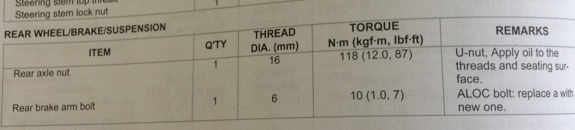

Anywhoo.... I do not yet own a service manual. Can someone look up the the torque specification for tightening the axle nut?

Glad to hear removal was easier than thought to be. Here's a snapshot from manual. Get 'er done and go for a ride. It's Sunday, my favorite day to ride. Temp will be reaching 91 degrees here....HOT!

How about that!! Found in a snapper! Both! 8)
