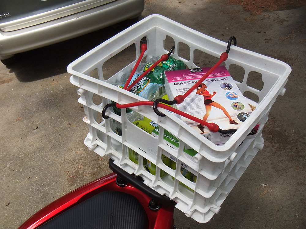

I find the Givi Monolock not very handy for everyday errands... weird shape and the lock is funky to say the least.

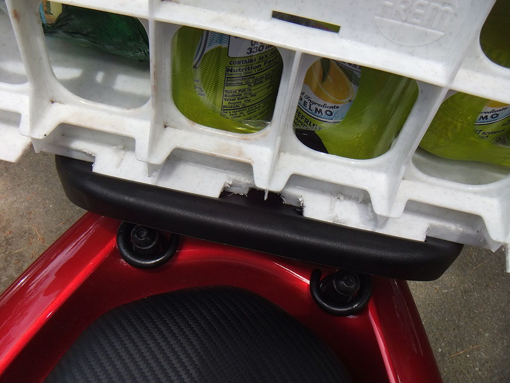

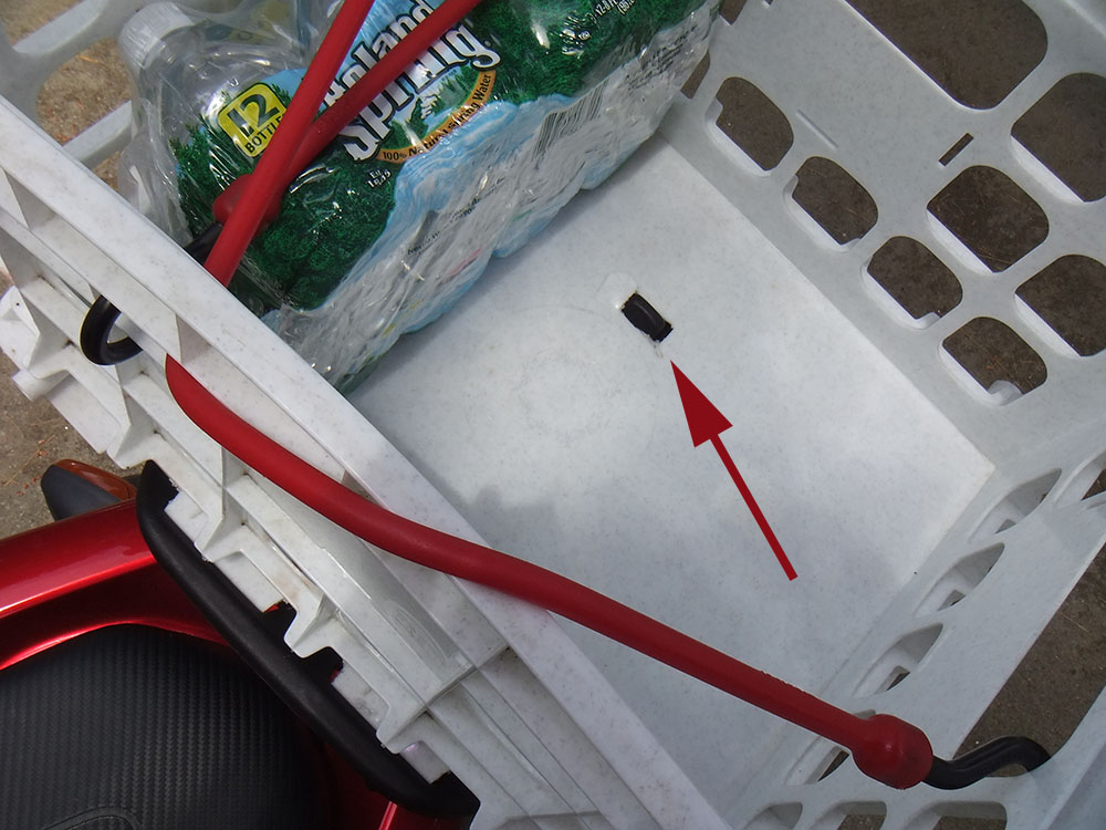

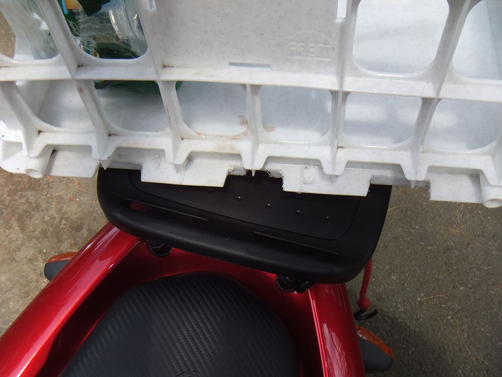

Found a milk carton that I could cut some tabs in the front that would clip into the mounting plate... also cut a rectangular hole for the "tab", keeps it from sliding around.
A couple of 18" bungee cords (red and black match my bike nicely!) http://amzn.to/13mMkmH Comes off easily and can be used as a basket in the store.
Works like a charm! Add other size cords to taste for holding down stuff, but not sure it's necessary- unless your roads are particularly bumpy!
