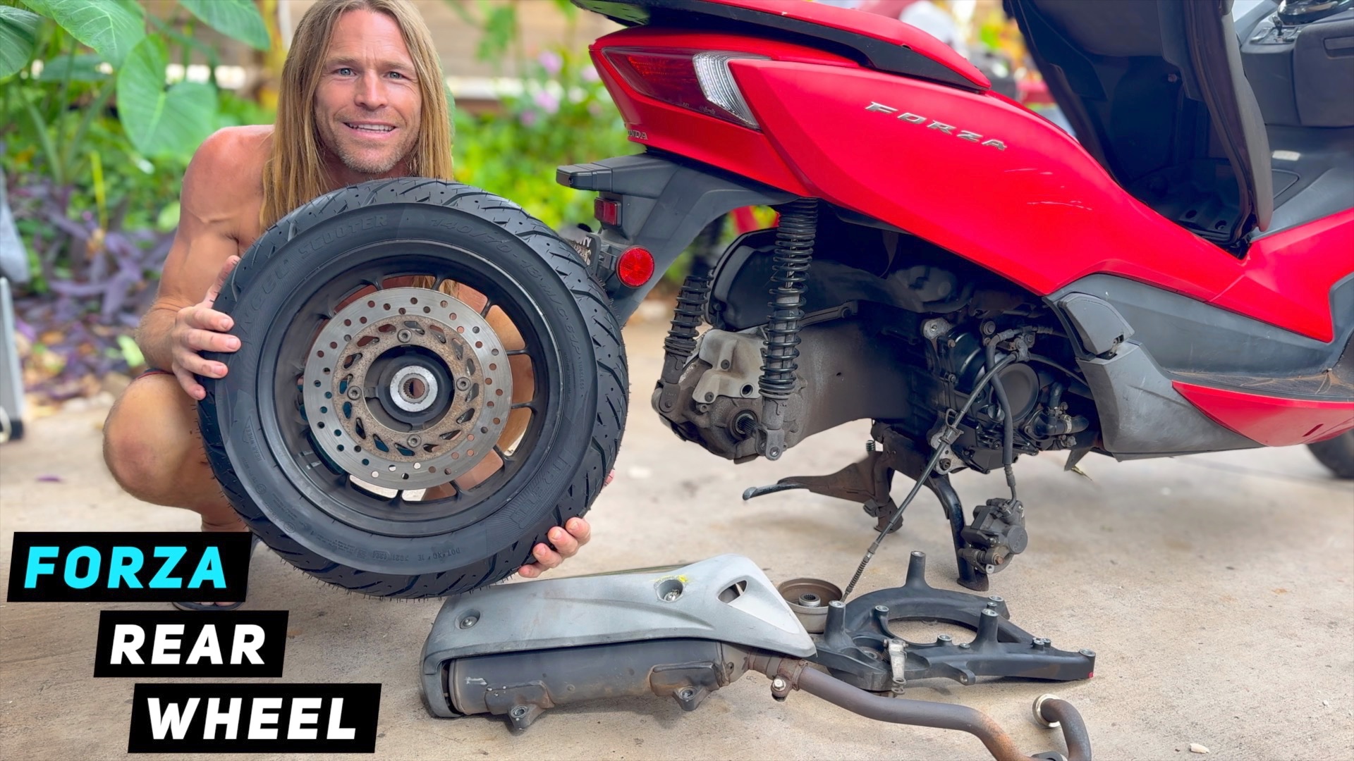

In this video I show you how to remove / install the rear wheel on Honda Forza 300cc scooter.
Tire change video: https://youtu.be/Bn5N_WT7eIs
More tutorial videos on this model: https://bit.ly/HondaForzaMSS
VIDEO: https://youtu.be/AFxX_C7alp8
forza rear wheel thumb.jpg (586.13 KiB) Viewed 17072 times
