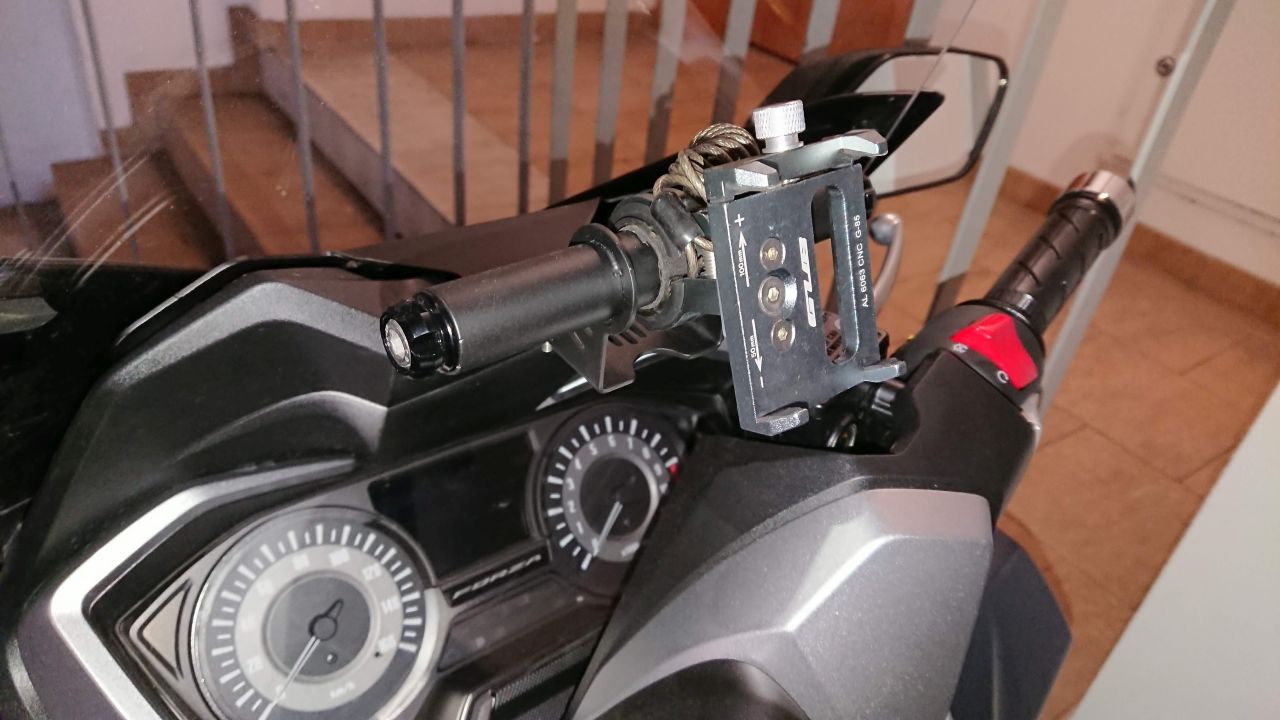

On my Forza 300 I have this https://www.aliexpress.com/item/33013246820.html
with this holder https://www.aliexpress.com/item/1005001463776533.html

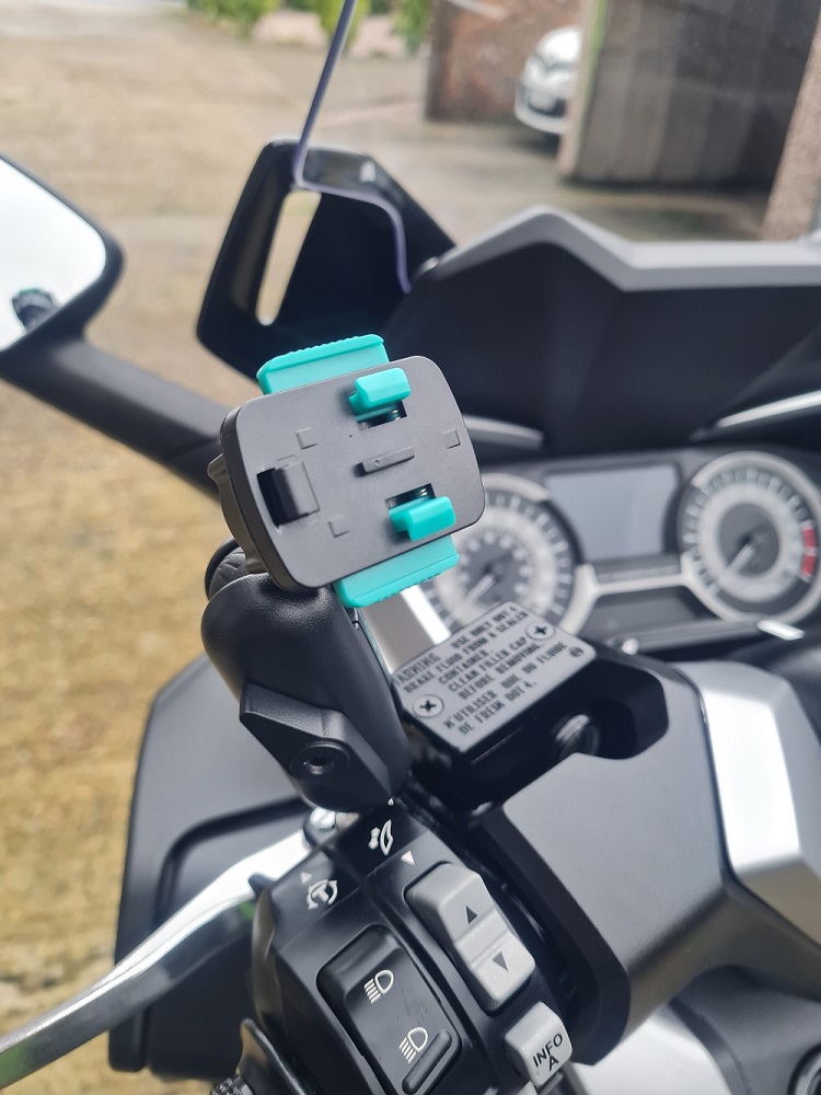

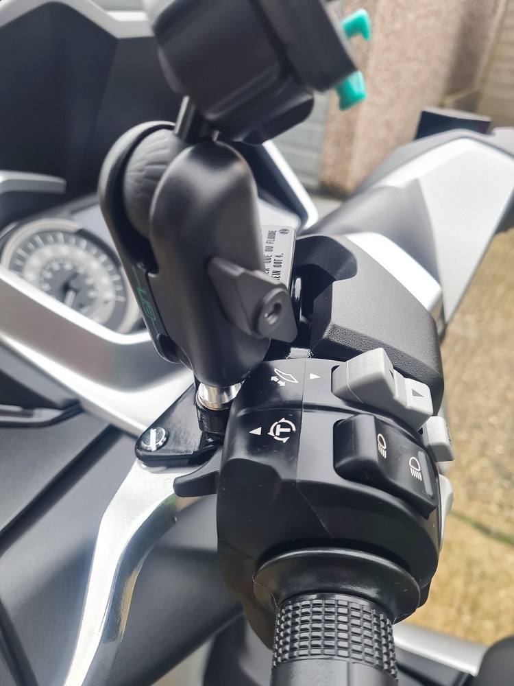

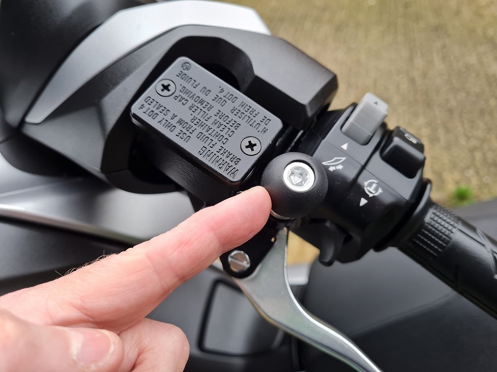

Here you are, minute job..mikeoc wrote:What did you go for? Can you show a pic when you gave it set up?

Didnt need to take anything off, I just used the unused mirror mount on handlebar by the rear brake lever.

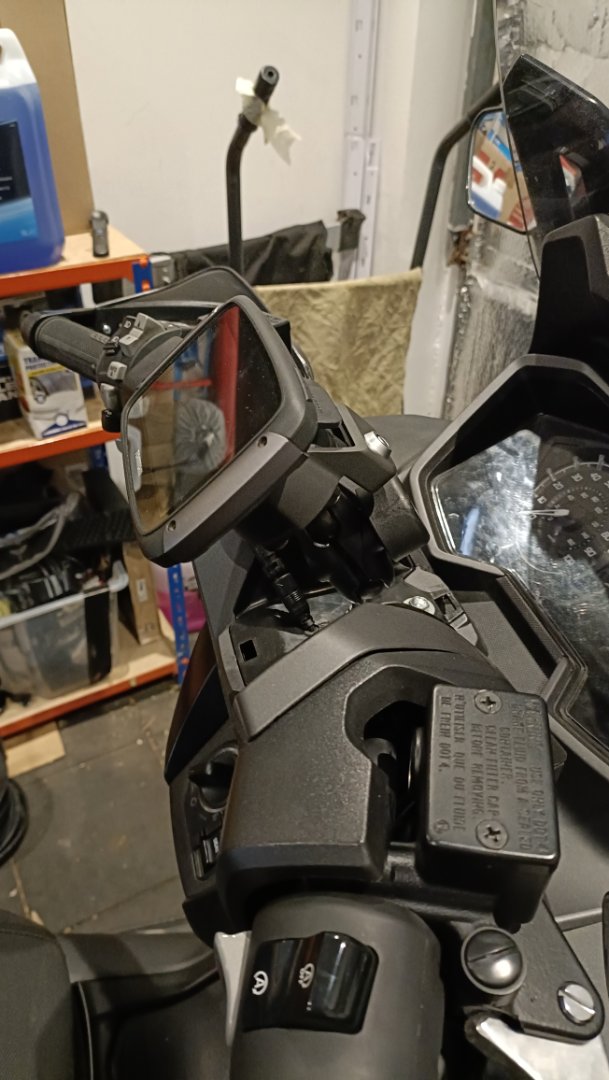

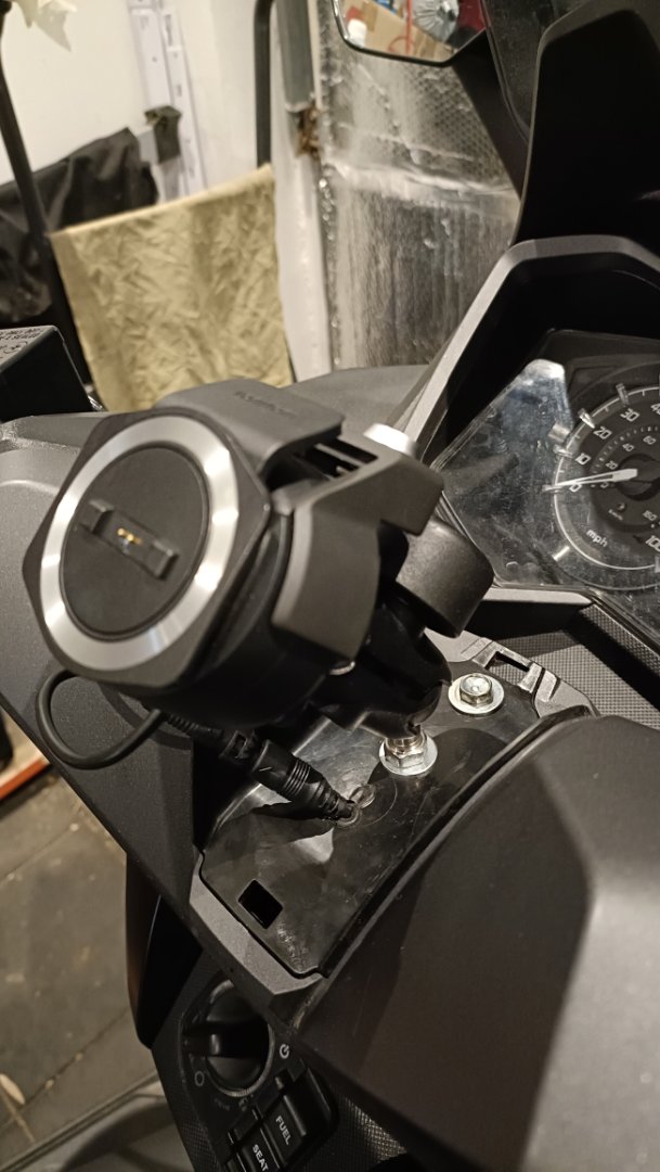

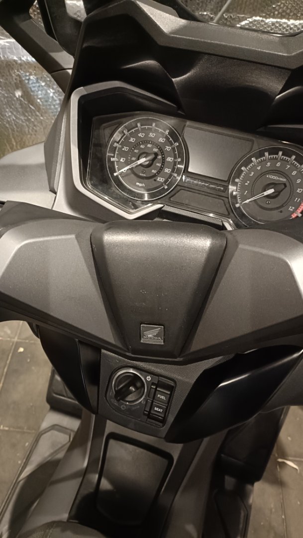

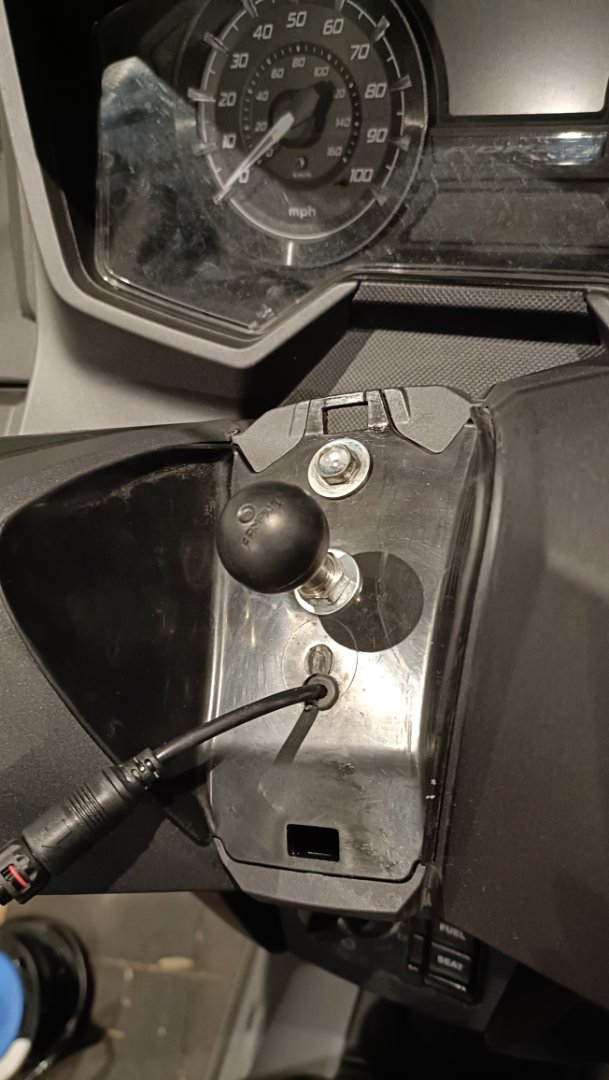

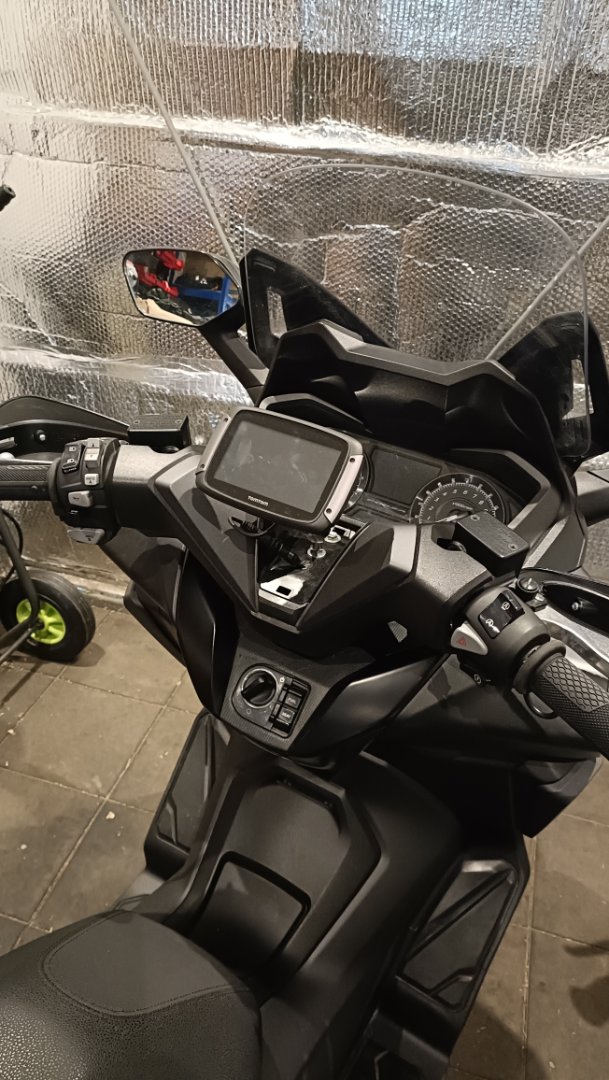

I've just mounted my sat nav on my new Forza 125, but prior to that, was looking for mounting suggestions on YouTube, etc. Everything I found seemed quite convoluted or required adding a lot of clutter. Anyway, I noticed there was an unused female thread in the centre of the handlebars, underneath the central plastic cover, which is very easy to remove and put back again.
It seems to have been overlooked by all the various YouTube how-to's I watched.
Turns out, it's an M6 thread, so I just bought an M6 threaded Ram ball mount from Amazon. Drilled a small hole in the plastic panel near it to thread the power cable through it - job done. Neat, along my central line of sight, and the best part is that when I'm not using the navy, the ram ball is small enough to allow me to replace the original plastic cover so you would never know it was there. Here's the link to the M6 RAM ball mount.
FANAUE 1" Ball Adapter Compatible with RAM Mount B Size 1" Ball Double Socket Arm with M6 x 1.0 Threaded Post for Extended Connection to Any Phone Mount That Supports 1" Ball Heads. https://amzn.eu/d/gfSOcp2
