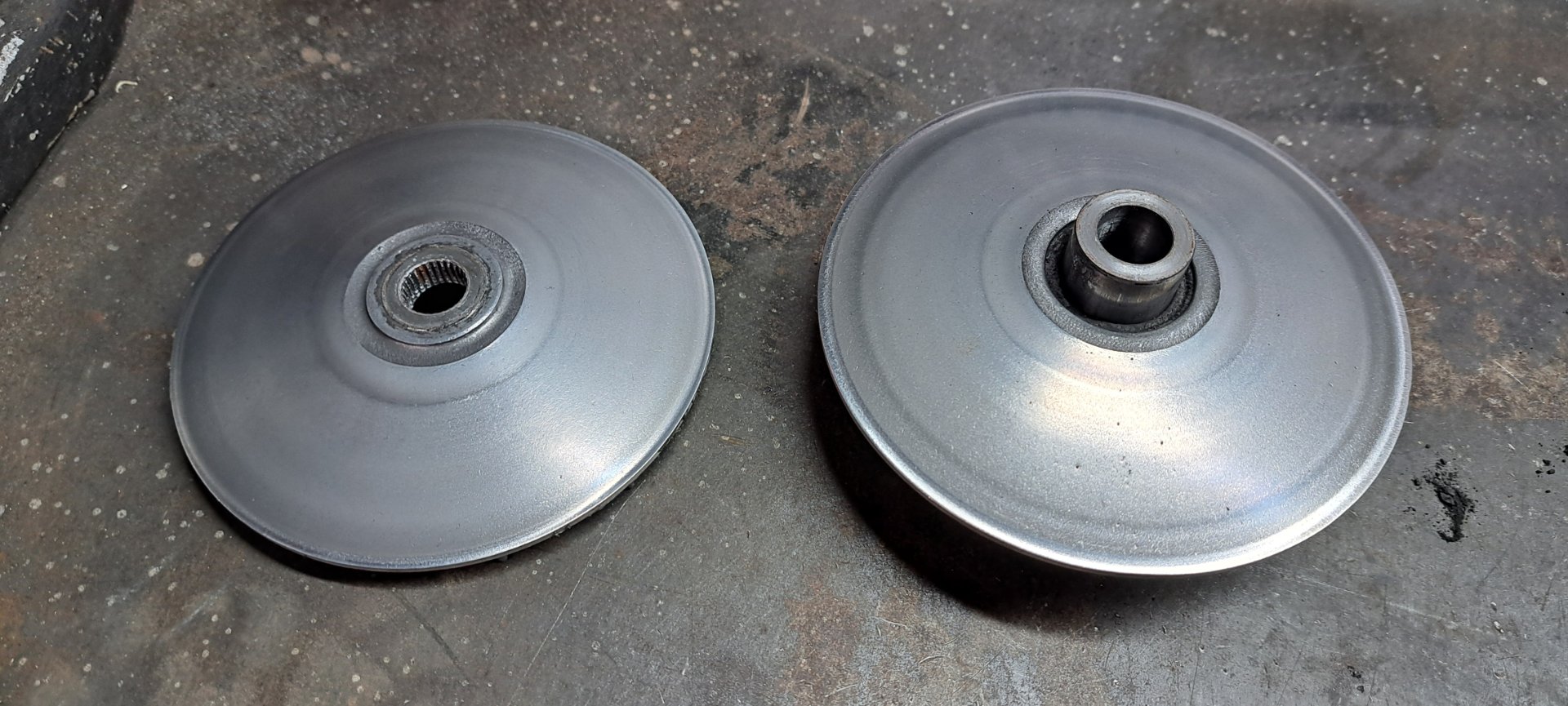

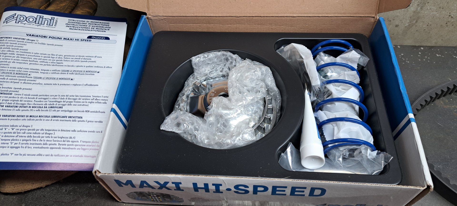

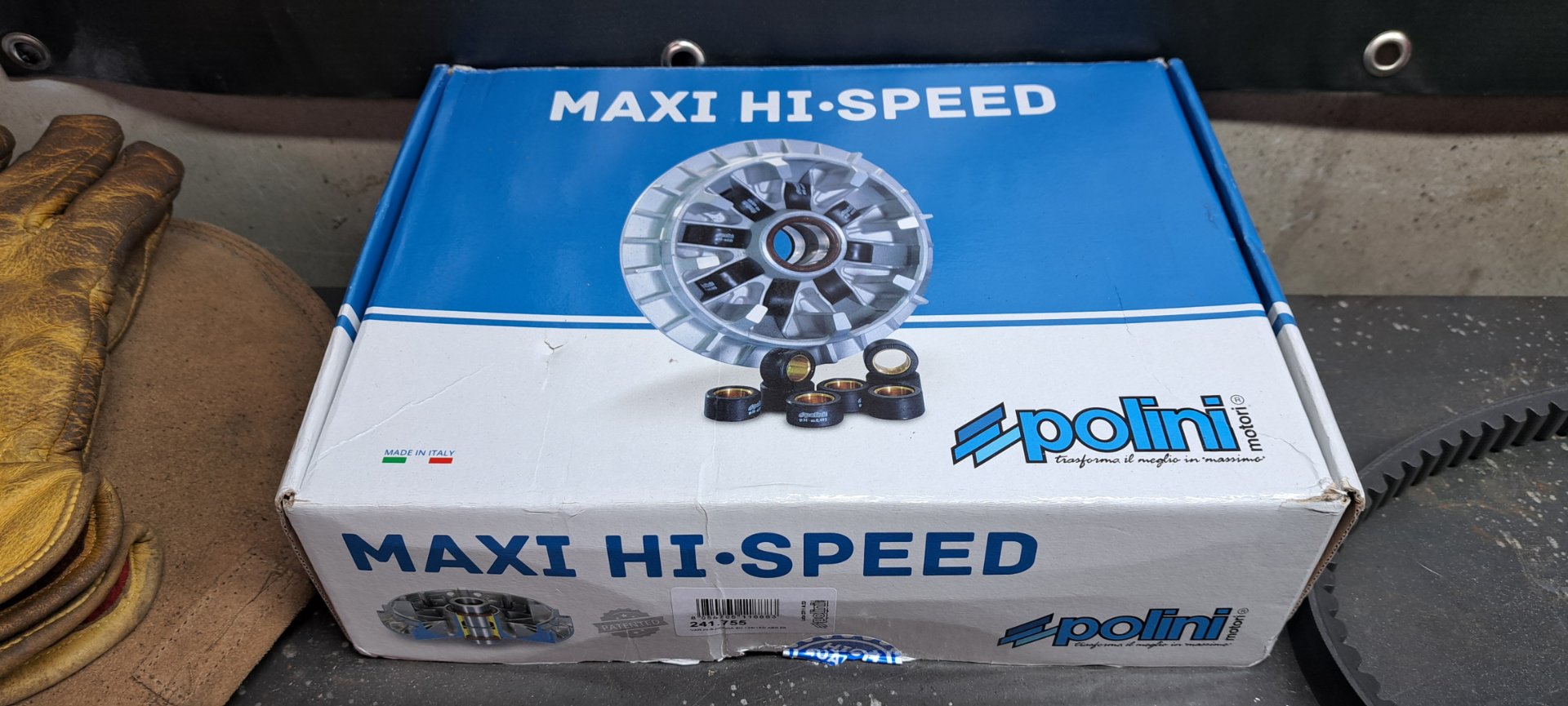

Bought the polini high speed variator rollers put on the pcx125 21 current model and its discraceful. So the bike with the kit fitted was doing 62mph flat out on the rev limiter with it fitted. My standard variator that I modified is good for 73mph and 78mph on the limiter (bike doesn't have power to get to that speed). So I'd advise everyone not to use the polini kit.
Anyone has any recommendations to better my set up I'm always up for improvements. Running 14.5g rollers and standard rear variator. I am running slightly heavier clutch springs for a more sprightly get away and different clutch basket too
Standard modified variator

78 mph indicated is pretty good for a standard 125 bike with tuned variator. 75 would also be good. As we don't know your weight or height. I.e. are you small and ride tucked🤔
Did you fit the whole Polini kit?
According to my info the kit in that picture is for a SH125/150. OK they share the same engine but the final gearing will be different as SH has larger wheels.

Does your Polini have 9 weights or 6? The box in your picture has 8 🤔 Stock PCX has 15g weights so 6 x 15 =90g total. 9x 10=90g but 8 x 10 = 80 or 13.3g equivalency.
Usually, kits like Malossi come with a stronger spring to keep the transmission "tight" and need heavier equivalent weights.
For a 6 weight unit with stock spring you need 12.5/13g. So with your 10g ??? Polini Blue spring is +15% so you would need slightly heavier weights than that. If you have 8 weights the maths works out in theory but your experience says not in practice

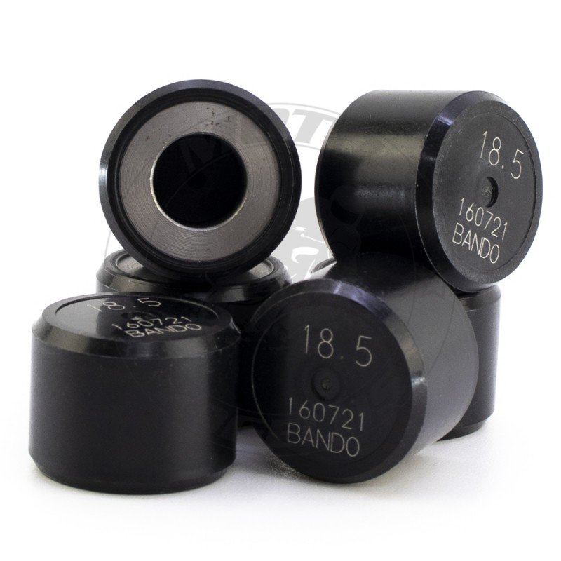

Standard UK model 21 22 came with 18.5g 22123-K1Y-J10 from honda. Hondas new replacements are now 19g for some reason. I'm run in standard honda belt too as not be recommended any alternatives and seams to run ok
