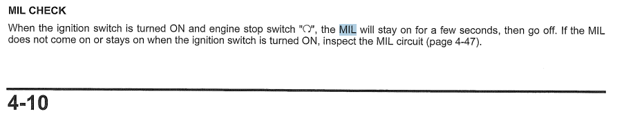

Apart from what is stated above (battery) - check as what is stated in the SM for when the MIL light does not come on:
That is basically the only thing I could find in the SM about the MIL not coming on. Hope it helps.

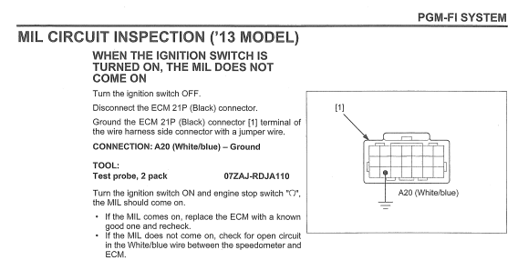

Oh and this but it refers to the image above:
