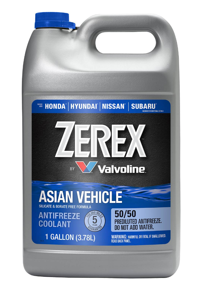

Hey all. I'm looking to change the coolant and final drive oil in my 2016 PCX150 for the first time and I'm trying to make sure I'm using the right stuff.
I saw Mitch's video (https://www.youtube.com/watch?v=4oNMirMiJls) of him changing the coolant in his PCX and he used the gallon pictured below. I went out and bought it from my local auto part store since there's no Honda dealers around me. Is this coolant good for my PCX?
Also, where can I order final drive oil from? or which should I use? Thanks in advance. I'm still new to maintaining this beautiful bike.

Re: Coolant / Final Drive Oil
I do not know the coolant you showed a picture of, so I cannot say whether it complies with Honda's specs for the PCX, but, my official PCX manual says this...
Pro Honda HP Coolant or an equivalent high quality ethylene glycol antifreeze containing silicate-free corrosion inhibitors.
The coolant system volume is smaller than most people imagine. You do not need a 5 litre container.
I used a cup of coolant and about the same amount of water, which is enough.

Unfortunately, all coolants I've found in places like autozone and oreilly's only come in the gallon size.pxc-in-japan wrote: ↑Fri Mar 04, 2022 11:29 pm I do not know the coolant you showed a picture of, so I cannot say whether it complies with Honda's specs for the PCX, but, my official PCX manual says this...
I'm only at around 2,600 miles, but I'm unsure if the previous owner ever had these fluids replaced. I've been on top of the regular oil changes at least. Should I even bother changing it with so little miles then?As an aside...
