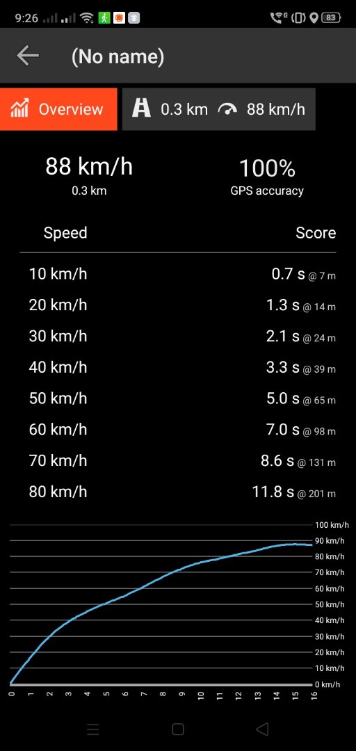

Stock 125i motor, 2019 Honda Click. Upgraded variator, 11gr Dr Pulley sliders. 90/80-14 front, 120/70-14 rear Pirelli Angel Scooters with about 9k kilometers on them.
