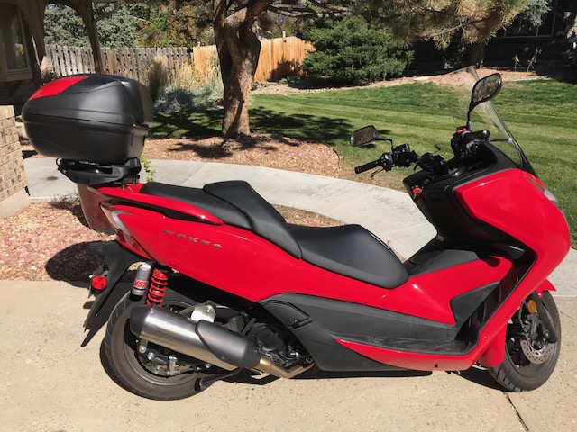

Changed shocks to the YSS TC 302-400-T Has made the ride much better
