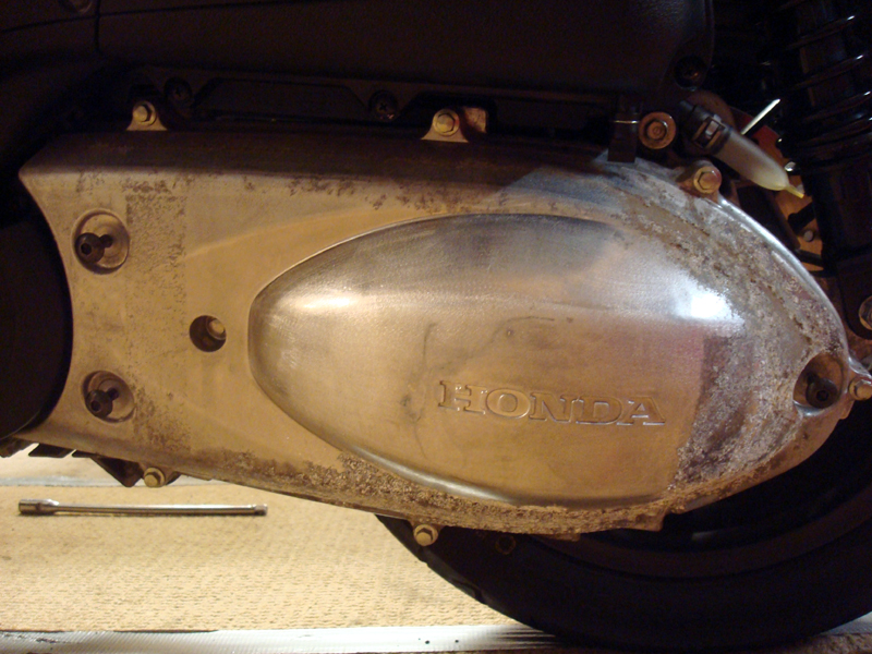

As I was cleaning my bike (2017 Forza 300) I pulled off the black plastic belt case cover and was shocked to find severe corrosion of the aluminium case. There were strips of foam stuck to the inside of the plastic cover and these were soaking up and retaining water and probably salt etc from the road.
Surely Honda did not add these bits of porous foam? The bike has had a previous owner but has only covered 1500 miles in 3 years, did he add the foam? Have you similar foam and corrosion on your machine? Worth a check maybe.
The foam was very well stuck but has been removed and the aluminium case cleaned up and protected from further corrosion so no lasting harm done.
GrahamH
Re: Belt Case Corrosion !
The foam is meant to be there, it prevents rattling.
If you take the corrosion off it will corrode again.
Best to leave it as is and put the cover back on.

My Forza was a lot worse than the photo - poor design which scoops rain water from the front of the cover and traps it behind the plastic cover. Not worth painting the alloy belt cover it as it is behind the plastic outer cover. Just rub the corrosion off and replace the plastic cover.

Jge64 wrote:You guys do whatever you want with your own bikes, I don’t care whether it’s behind a cover or not, I want the corrosion gone… This reminds me of a rotten wood wall painted with a fresh coat of paint; not on my vehicles.
It's a design flaw as the plastic cover scoops rain water at the front which gets trapped behind the plastic cover.

Iv'e started stripping the rear end of my Forza. I have previously removed corrosion and used ACF 50, it's just as rotten now.
I am going to wire wheel it and Waxoyl the casing

I have tried to wire wheel my corrosion. I gave up after a few hours. Mine looks horrible.

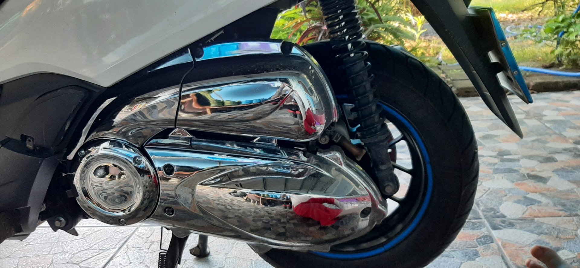

canthai
Posts: 94
Joined: Fri Mar 26, 2021 3:00 am
Post by canthai »
davenowherejones
Posts: 1844
Color: Silver
Location: Hope, BC, Canada
Post by davenowherejones »
Can you buy those parts?
canthai
Posts: 94
Post by canthai »
