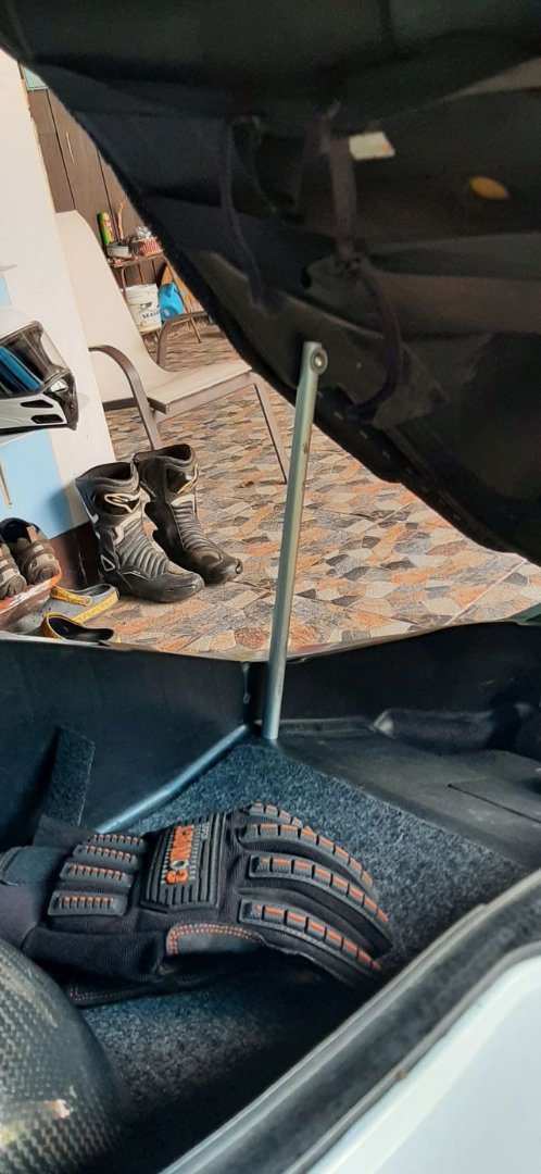

canthai
Posts: 94
Joined: Fri Mar 26, 2021 3:00 am
Re: Forza 300 2018 Seat doesn't stay up
Post by canthai »
Piece of aluminum tubing from an old TV antennae
