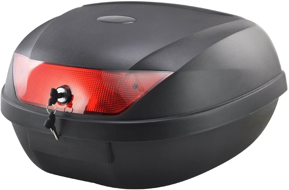

Hello, I bought my forza in october but unlike the PCX where its extremely easy to find & buy a trunk mount for, I for the life of me cannot locate one for the Forza.
Does the Forza have a buyable mount anywhere? I've attached a picture of the trunk that I have. Worked perfectly with the PCX, eager to put it on my Forza considering the bad underseat storage.

Try Givi. I have a Givi 65 liter case on my 2014 Honda Forza 300.
Or you can make one pretty easily with 4 bolts, spacers & flat plate. Bolt holes are there under the rear plastic, even marked on the back of the plastic. You need to drill the plastic.

davenowherejones wrote:You need to drill the plastic.
Or you can just leave the plastic trim piece off.
That way you can remove the rack without having to buy a new trim piece.

I went to Revzilla's site, told them what bike I had, what topcase I wanted to mount and they gave me the info I needed. I ordered the mount from them and it fit beautifully (about $96 but well worth it). My topcase is a Givi monolock and the mount went right into the marked spots on the tail.
