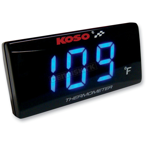

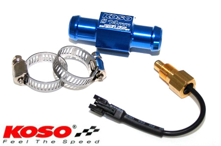

I have the Koso slim water temp meter with an 16mm water house adapter for the sensor. Like this one from webike, https://japan.webike.net/products/21346158.html
16mm adapter https://www.amazon.com/Koso-BG016B01-Te ... 5PTHBYZ6G5
On a side note, there are counterfit Koso gauges on aliexpress and other sites. While considerably cheaper, they aren't of the same quality. So decide if you wan't to cheap out or spend a bit more on original Koso gauges.

Oh, the 14mm hose adapter might fit better. The 16mm one was a bit tight with the hose.
