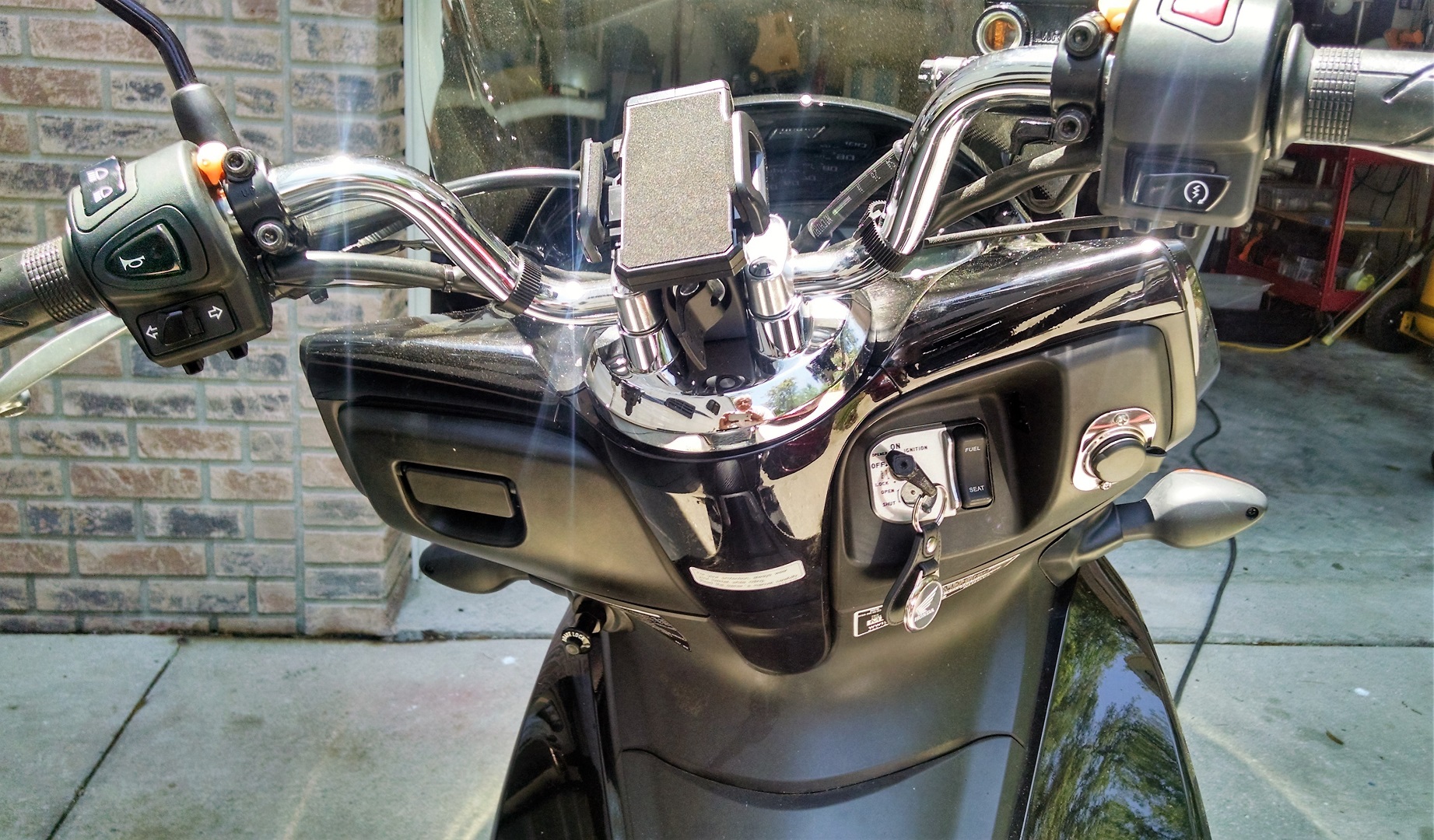

Like this?
12v socket pcx.jpg (892.83 KiB) Viewed 56242 times

Yes except mine is in the glove box.
