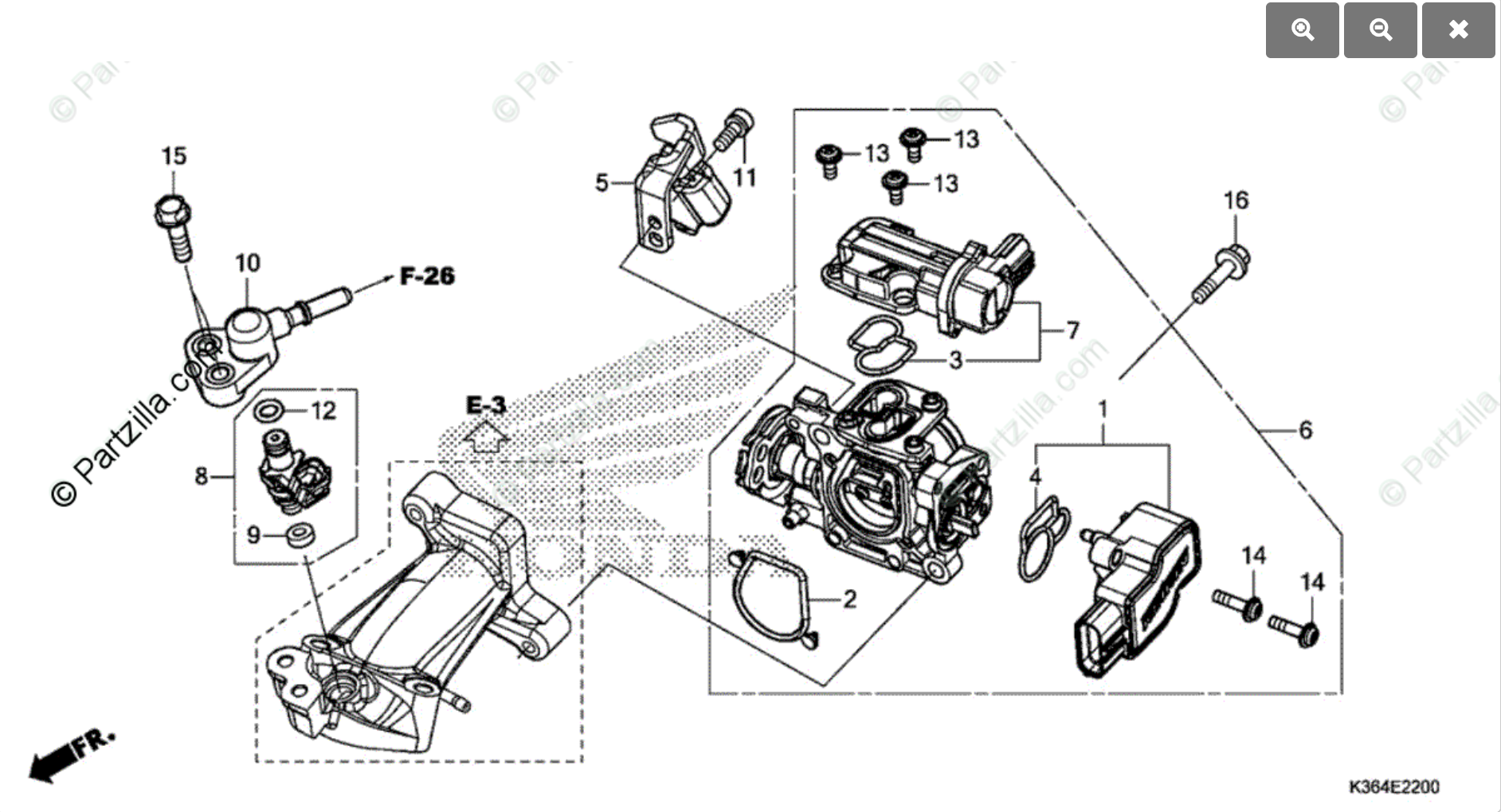

The IAC is #7 in the diagram. Not really a way to test it but only by cleaning it.
Screen Shot 2021-04-28 at 10.25.09 AM.png (1.03 MiB) Viewed 1366 times
