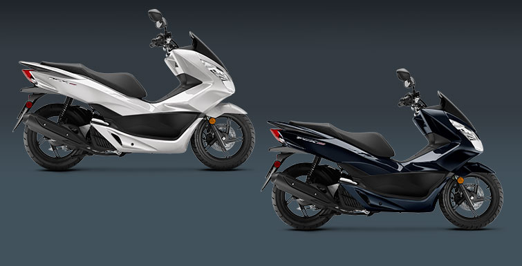

1. If it does NOT have led lights it would have been manufactured prior to 2015.
2. Prior to 2015 the front side panel looked like an open ' >'. From 2015 on the it was closed.
(On the 2013 model sent to the United States the bike came with stalk turn signals where the open area was. I will include a picture if I can find one.)
3. Many of the 2011 panels would fit a 2013 model. For 2015 everything was different. The 2014 model was an odd bike in that it was a 2013 model with LED lights.
My 2013 model. Note the open sideways "V" on the front left panel. After 2014 it was closed up.
I hope this helps you.
Here is a 2018 model. Note the closed V front.

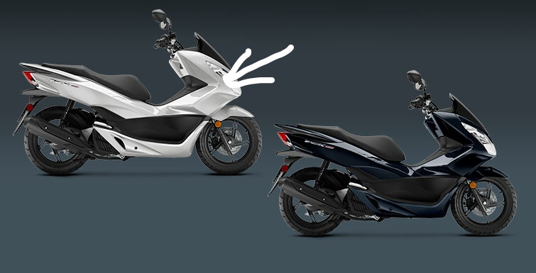

In case you are not sure what I am referring to when I mention the closed V, here is a picture of the 2018 in which I drew an arrow to the area. I hope this clarifies things better.

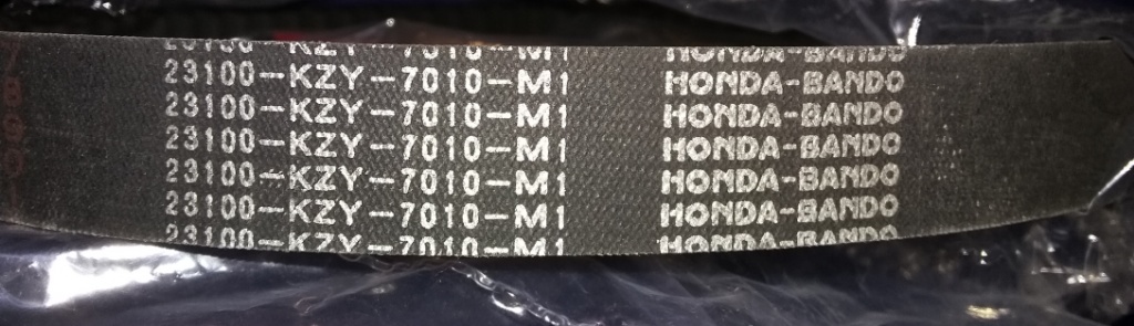

By the way, my drive belt part number is different from yours. Of course, mine is a 150cc and I am not sure what yours is. Here is a picture of mine. I can't find any references to the part number you gave, though.

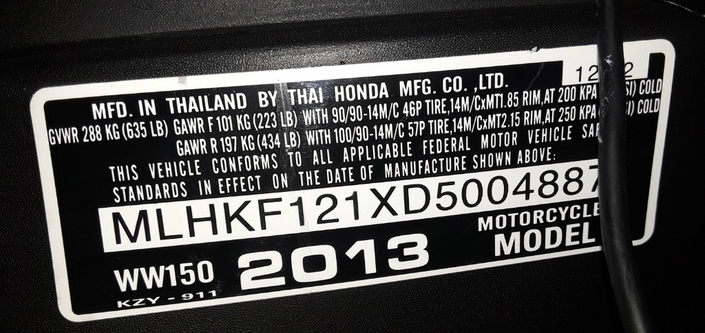

DushFernando92,
I was not implying anything by that, I am simply pointing out that the vin number is universally put somewhere on the bikes, but also are required to be very visible on the models going to the United States, so we have a plate attached to the right front panel close to knee level where everything is in big letters.
PCX-vin plate.jpg (241.17 KiB) Viewed 20174 times
Other scooter brands have their plate below the front of the seat.
In Sri Lanka there may or may not be a different requirement. If there is none then you would probably be using the numbering stamped somewhere. Since I don't have the slightest idea where that other place might be, I thought that it MIGHT be possible that you didn't either. Sorry if it came across as other than that.
