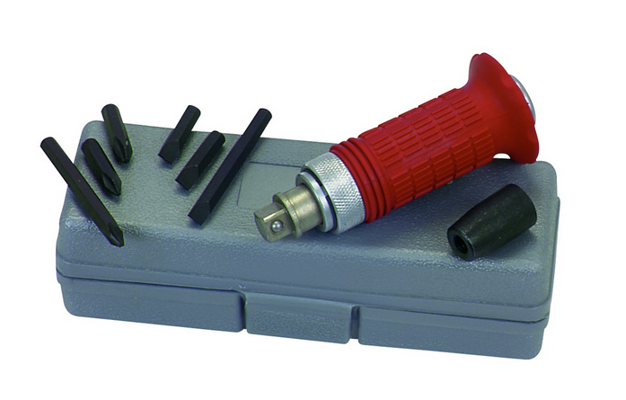

You can always use an impact screwdriver. The brake levels on a HOnda Ruckus are 10x harder than the ones on the PCX. Impact screw driver works like a charm. I personally had zero issues removing the ones on my PCX when I changed handle bars. Use a good quality screwdriver. Preferably one with a T-Handle if you have one.
These are less than $10 at harbor freight. No need to pay top dollar for something you rarely use.
