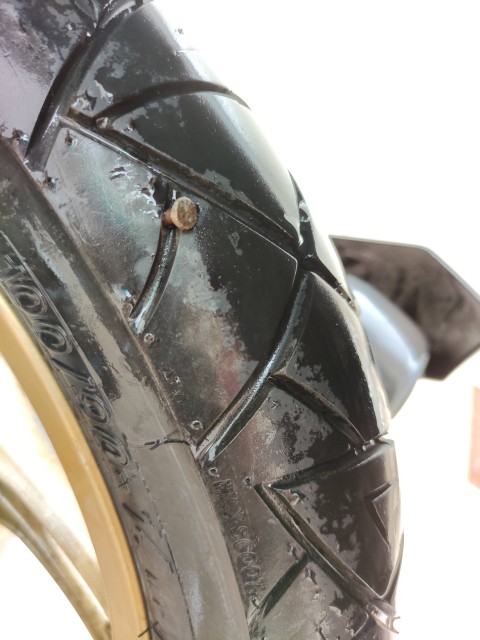

A very long nail hit my rear tyre 17 days ago. I just plug repaired the tyre. I checked the pressure often and it is holding up pretty well like a perfectly normal tyre. Now 1733km already with the plugged tyre. I plan to use it till it is worn out.
Re: Front flat tyre - only a few months old
raito wrote:A very long nail hit my rear tyre 17 days ago. I just plug repaired the tyre. I checked the pressure often and it is holding up pretty well like a perfectly normal tyre. Now 1733km already with the plugged tyre. I plan to use it till it is worn out.
Yes they are generally fine if the repair is in the main section of the tyre.
No need to replace the tyre at all.
It hit a groove, slightly off centre of tyre. It was newly installed tyre, only 13 days before nailed. Would be such a waste if I had to replace it already.
- IMG_20201214_105616.jpg (75.27 KiB) Viewed 11857 times
