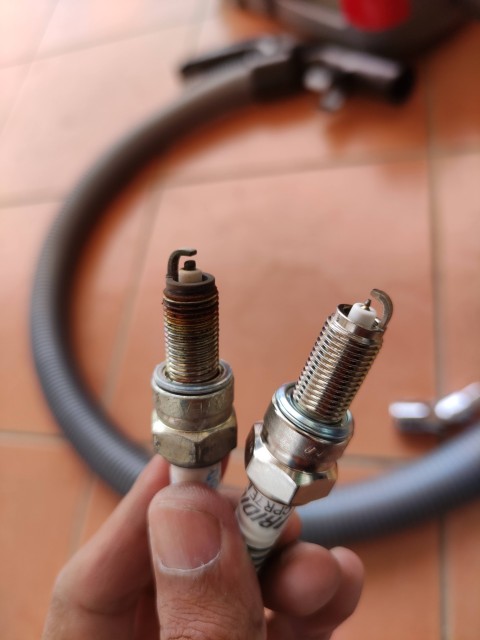

I don't know about Performance but I changed the stock plug at 30288km with the Iridium plug NGK CPR7EAIX-9. Now almost 15000km later, I am not sure it made any difference. Do you change plugs every 8000km (5000miles) like in the manual?

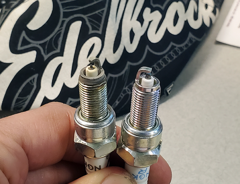

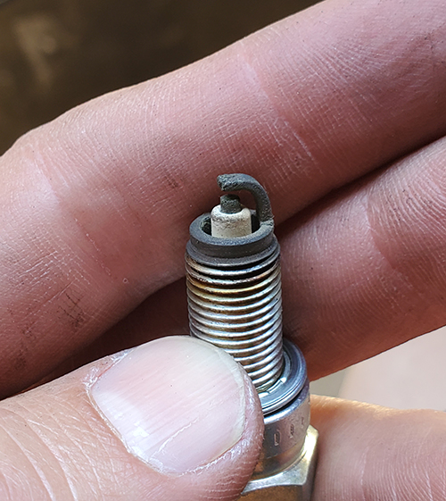

Re: Performance Spark Plug
I totally forgot I swapped to the iridium. Same one raito runs. You can see how lean its running from the white coat on it..
Just found the original plug before I changed to iridium.

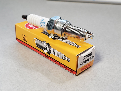

Here is the iridium with maybe 1k miles. You can see how lean its running from the white coating on it. New Colder NGK going in.

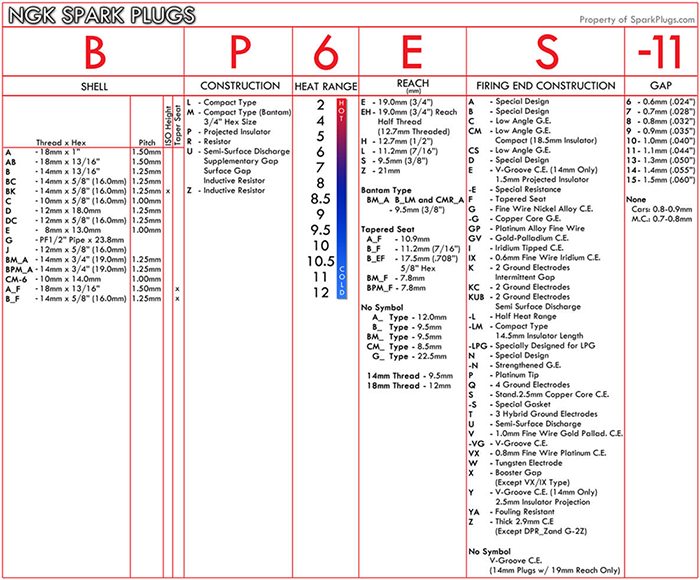

Cool little observation.
Stock: 6
Iridium: 7
Latest one i installed: 9
Stock: 6
Iridium: 7
