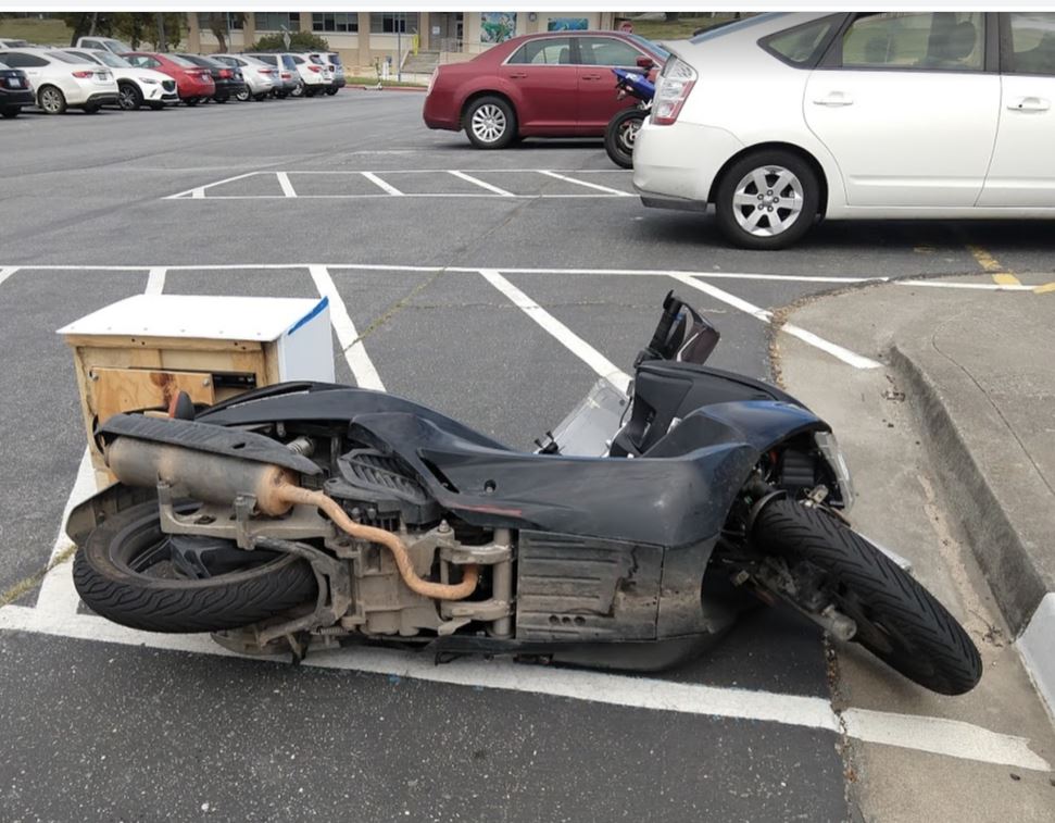

As for mods and tips, I added a wireless charging pad to my phone Ram mount. It mostly worked, but it was a quick DIY. I made a big coroplast box with an internal insulated bag with sliding rails so that it would reside over the passenger space and not stick out too far back, but also move out of the way when accessing the underseat storage. The only pic that I found was when the wind tipped it over during class time,lol. In the pic you can see the underside of the box.

Seeing a scooter on it's side is painful . . . hope you didn't suffer any major damage. Damn the wind eh??I haven't rident the xmax 300, but I'm sure it would be fine in a flat area.

The wind turned your bike over? It must have been a big wind. On windy days I suggest putting it on its side stand, leaning it away from the wind.
I have had bikes all of my life and only once did the wind turn my bike over. That occurred on a windy day when I put it on its side stand without thinking about which way the wind was blowing. Parking it in a position that makes the side of it act like a sail will definitely get it moved. Putting it on its centerstand is ok if it is not broadside to heavy winds.
Having something on the back of it that is tall enough to help that "sail" effect will definitely put the bike on its side! Was that cabinet that is beside it in the picture on it at the time?
That particular day the winds were gusting up to 45 mph. Trying to ride was difficult. I didn't think about the sail effect back then. (I shouldn't have been riding that day because the winds were horrible, but I didn't have a car. It wasn't recently, but when I was much much younger and less experienced.)

@Mel46 The scooter tipping over was kind of my bad. It was forecast to be windy that day, but i got laisy and parked it at the most convenient motorcycle partaking spot. The parking spot was cresting a hill and perpendicular to the wind. I was more careful after this tipping. The box did make the scooter a bit more sensitive to wind, but nothing crazy.
