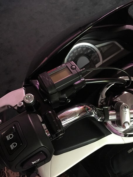

Koso is nice, no mount kit comes with it so you can fix it anyway you like. Recommend strapping to the bars somewhere with velcro or bands. All you do is wrap the lead around the sparkplug wire several times. I has the ability to show RPM for single or multiple cylinders, comes set up for twin so you must change its default setting. The instructions are in broken english but you can read between the lines. You will need to remove the lower panel to route the wire with any tachometer.
Fix it to the bars, run the leed down the column with the rest of the cables. Guide it along the undercarriage to the sparkplug and wrap it around the wire 10-15 times. Done!
https://www.amazon.com/Koso-BA003040-Mi ... tachometer
Now they have a stainless bracket for it 8) I may have to order that since I don't use my rearview mirror mounting locations it would bolt there nicely. But check to see if there is anywhere else to bolt the bracket before you buy it.

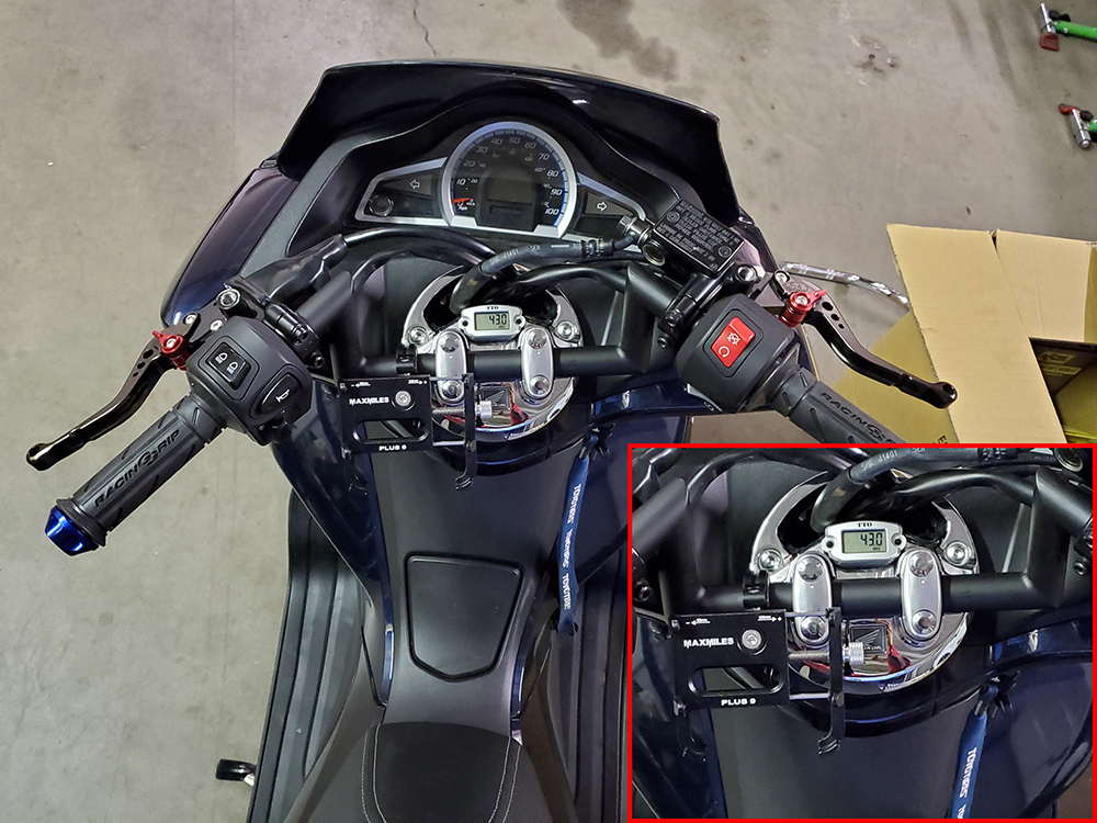

I cant stand not having a Tach on my bikes. Mandatory to tune the CVT properly for performance.
TTO tach. Highly recommend.
