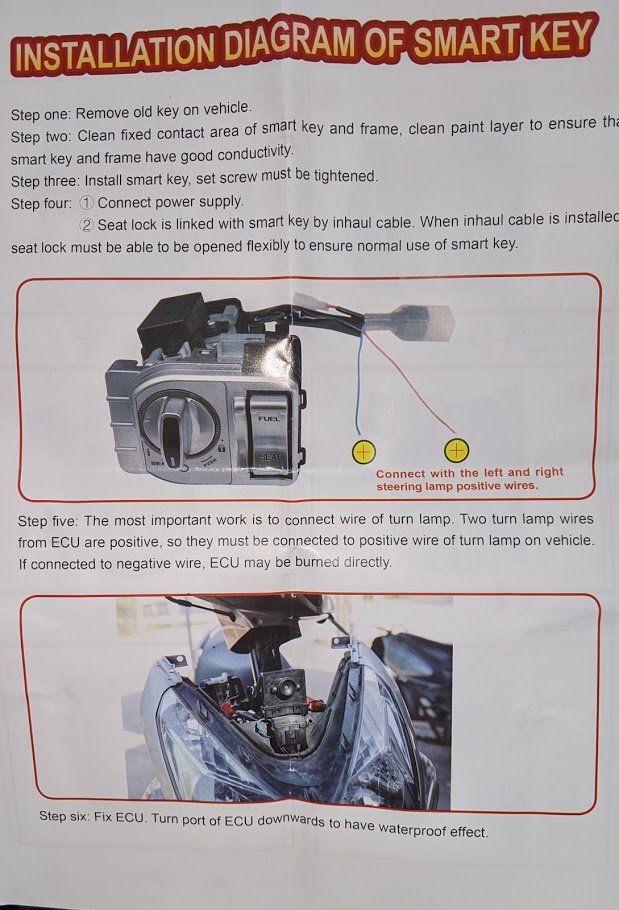

The install would of been easier If I had the newer PCX with LED headlights. The kit I got was designed for those newer models. Which made my install a little more difficult. On the newer PCX it would just entail removing the old ignition lock, sand the mounting surface on the corresponding part of the frame where the ignition lock mounts too. Plug in the PCXs stock wiring plug into the ignition unit and wire in the left and right turn signal wires and done. Unfortunately My PCX is the older model 2013 USA spec.
The install onto my 2013 PCX required the use of the stock pigtail that comes out of the stock ignition lock. I desoldered it from the lock and soldered it onto a short changeable adapter harness that comes with the kit. It's kind of odd, but two wires that go from the New ignition lock to it's control unit, have a small removable harness that have different pinouts. My PCX only has two wires going to the ignition lock, the newer PCX models have a bigger socket with upto 4 pins on it. One of those wires come from the battery and the other one goes to the main relay and powers some components on the engine directly. The keyless unit gets its ground wire connection through the chassis, that's why the frames mating surface has to be sanded a bit. Hope this was clear.

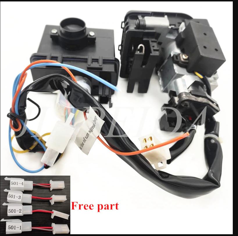

- Keyless.JPG (87.33 KiB) Viewed 10899 times
- I bought the 501 unit, the 503 would of been a plug and play for my scooter.

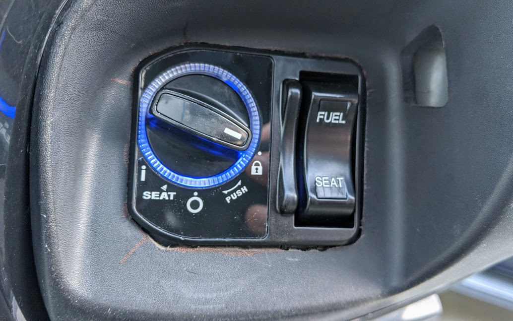

I finally dremeled the plastic that goes over the ignition lock. My dremel grinding skills sure need some improvement, but it came out ok. I should of taken my time with the dremel. The bottom part of the plastic I used too high of speed and too slow of a pass on the plastic, to an extent that I cut into the plastic instead of shaving. I'll just leave it as it is.
- IMG_20200520_185326.jpg (167.08 KiB) Viewed 10857 times

I have been wanting to do this for a while now. Does the ring around the toggle light up too?

It does light up, but only the bottom half lights up blue. There is only one LED for the blue ring light. You can see it light up on the last picture. It will definitely be a bolt on and plug in affair with your LED PCX.Conelite wrote:I have been wanting to do this for a while now. Does the ring around the toggle light up too?

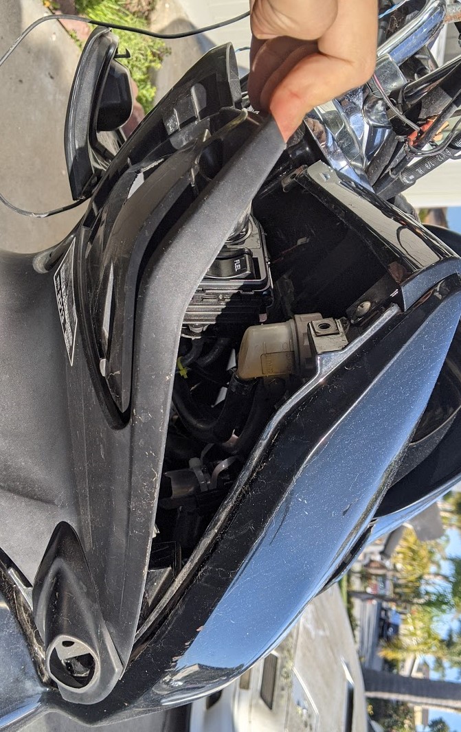

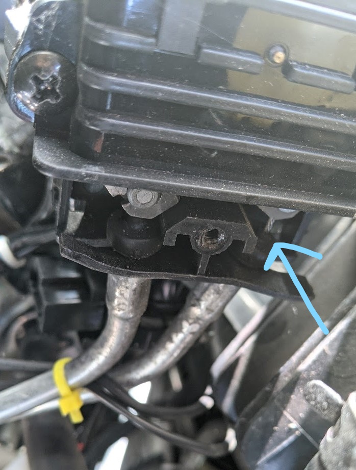

Funny you asked about this. If the scooter isn't riden the unit will drain the battery in a bit more than a month. Because covid, I haven't rident it that often and the battery has died on me twice already. What I had to do was to remove the plastic cover around the keyless ignition unit in order to reach the seat cable to unlock the seat. I have been meaning to add a trickle charger cable so that the battery wouldn't die, but have been lagging on it. The unit still works great even though I leave my scooter outside. I just tried to unlock it from inside the house and no noise, so I'll have to take the panel off again in order to charge the battery. Will update.malxerr wrote:Hi Gil,

Here are some pics on what has to be removed to access the battery.
- Use screwdriver to push on the seat lock cable.
- PXL_20201129_224531809 (2)_LI.jpg (2.11 MiB) Viewed 10228 times
- Philips screwdriver and a 10 millimeter wrench to open up the panels.
- PXL_20201129_224517821 (2).jpg (274.08 KiB) Viewed 10228 times
