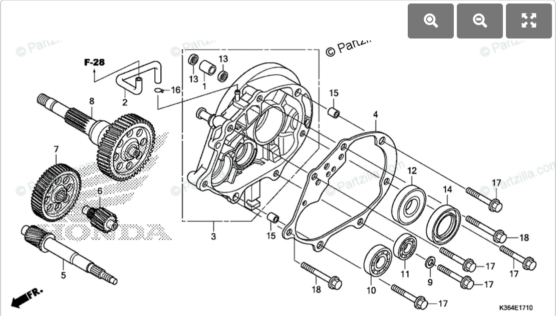

Gil wrote:I didn't catch that you installed the drive face too on your PCX. I wonder if that means that the stock variator and drive face is better than the NCY variator kit. The yellow coating also fell of on the my old NCY variator.
Its not that, Its just that the newer models have shorter gears so even with an aftermarket Variator and DF you still cant get higher speeds without changing gearing or removing the limiter.
Here is the image of the transmission/Gearing diagram for reference.

think i did the math correctly on the above years and the gearing and i would say the 2019 has the tallest gearing. not what ive always heard, but if you calculate how many times the drive shaft turns for each 1 turn of the final gear (rear wheel also which it is directly attached to the final gear shaft), its: 2013 - 10.55 turns 2018 - 10.75 turns 2019 - 10.08 turns. more turns would be shorter gearing more power less top end, less turns would be taller gearing with less power and more top end. I'm open to being wrong here on my math with the above gears, but thats what i get.

correction to my 2019 turns... make that 9.85, even taller i think

The 150cc manual for 2013-2017 models gives final reduction for 2013 models of 10.552 and 2014-2017 of 10.751, all 153cc across the range. Not got the 125 manual to hand. So your calculations match the official honda doc's for 2013-2017.
Not sure about 2019 versions but the 2021 specs seem to suggest even the 125's (all we can but in the UK) have more power than before.
