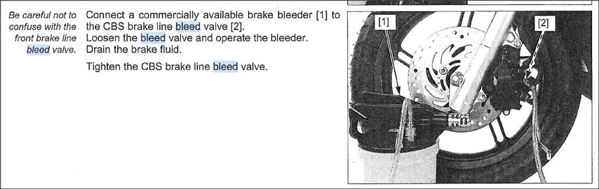

I made a mistake and I got air into the system when flushing the brake fluid. Which one is for bleeding air 1 or 2? Please see pictures.
How do I fix ?

Top one is for front brake bottom one is for the CBS system.
