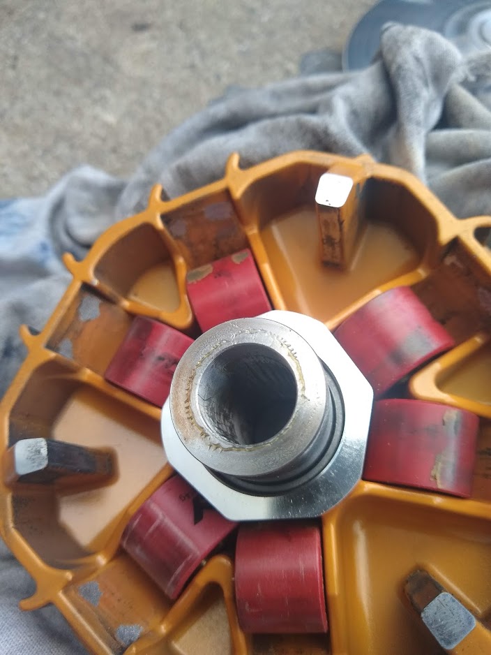

Hello, I installed an NYC Variator, drive face and 14g rollers in my scoot and saw 0 improvement in top speed and didnt appear to have any better acceleration. I took out the 14g rollers and installed the stock rollers which weighed in at 17 grams. My top speed was unaffected and remained at 66mph hitting the limiter. I only have 1,000 miles on the scooter so the belt should still be like new. When new I could hit 70mph completely stock. I'm baffled at why there was no change in the top speed with 14 and 17g rollers. Seems like some other limit not related to the variator.
Another thing I'm disappointed with is the coating on the variator is already failing at 20 miles as shown in the pic.
Side note, I've tried to register several times previously with a gmail account but never got the the activation email.

Not interested in any such mods myself, but I wonder if that is a fake NCY setup - the rollers look in dire condition as if they will stick with all that crud on them (paint and dirt).

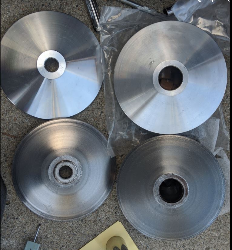

The outer NCY variator pulley is the one that makes the difference, in regards to top speed. The ramps on the NCY are different and have a different feel. When I installed a new MFR variator kit to replace the NCY I lost the Top speed of my scooter. The outer variator is machined down .7mm. At the spot where the boss touches the outer variator pulley. The .7mm of removed aluminum allows for the variator to close up a bit closer and that pushes the belt out just a bit more. My top speed is now ~74 mph down a steep hill, LOL. Here are some pics.
- Top new MFR, bottom NCY inner and outer pulleys.
- variatorBefore.JPG (103.75 KiB) Viewed 25951 times
- Machined MFR outer variator.
- variator.JPG (42.02 KiB) Viewed 25951 times

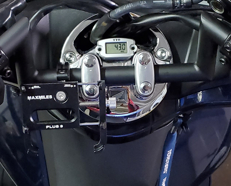

Check your tire pressure. Also look into a tach. TTO is cheap enough and its a simple reference to see what the engine is actually doing.

Tach also dispays your highest RPM achieved when you switch off.Conelite wrote:Check your tire pressure. Also look into a tach. TTO is cheap enough and its a simple reference to see what the engine is actually doing.
Another thing to consider is the Drive Boss. I never compared it on the PCX but I know on the Ruckus, different bosses are different length. That plays a huge roll on how much the Variator can move. Compare the 2 and see if there is any difference in length.
Which is handy...after a run.

I believe they also have a tach with a CHT - Cylinder Bead Temperature gauge. Easy to install, just uses a thin ring that fits with the Spark Plug’s crush washer. Gives a real time reading of the plug / head temp.fish wrote:Tach also dispays your highest RPM achieved when you switch off.Conelite wrote:Check your tire pressure. Also look into a tach. TTO is cheap enough and its a simple reference to see what the engine is actually doing.

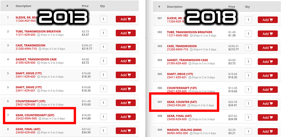

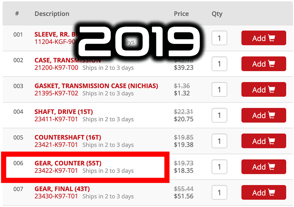

Here is the only thing i found comparing years. This is the gearing set from 2013 vs 2018. Definitly different. Hey look at that, the 2019 is even shorter of a gear.
Now we know. So what you can do is spend less than $100 for a full set of gears from a 2013-2018 bike and gain like 10mph.

Conelite wrote:Here is the only thing i found comparing years. This is the gearing set from 2013 vs 2018. Definitly different. Hey look at that, the 2019 is even shorter of a gear.
Nicely done, look at the final gear for the 2019, it's 43 tooth. So even shorter gearing.
The Kitaco gear kit might work with the 2019 PCX, It's 51T. I bought it for my PCX, but I haven't installed it. I bought it from webike.com .
