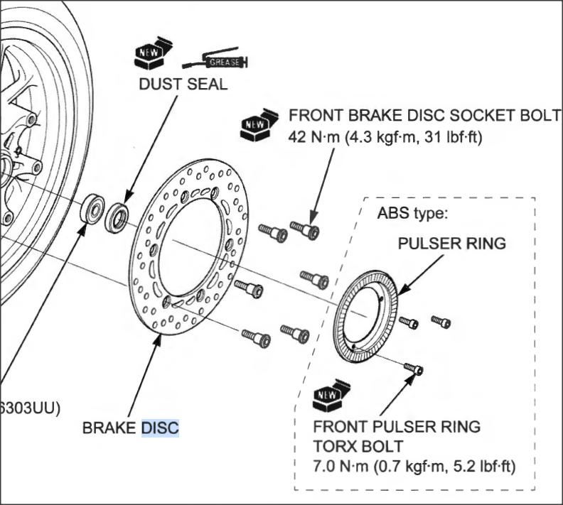

So my front brake disk is basically shot and I've got a Malossi disk arriving today, does anyone know where I can find the torque settings for the disk bolts please. Cheers.

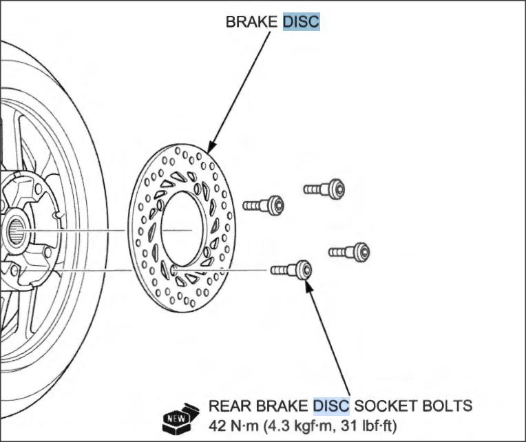

These are from the 2014 - 2016 Forza 300 service manual (Disclaimer:I would imagine that the 125 and the 300 should be the same):
Snap 2020-06-22 at 07.13.06.jpg (70.93 KiB) Viewed 7747 times
Snap 2020-06-22 at 07.12.17.jpg (50.34 KiB) Viewed 7747 times

Thank you Limey that's a big big help mate. Where did you find that?
I'm going to change the rear disk as well so I'm looking for how to remove the rear wheel.
