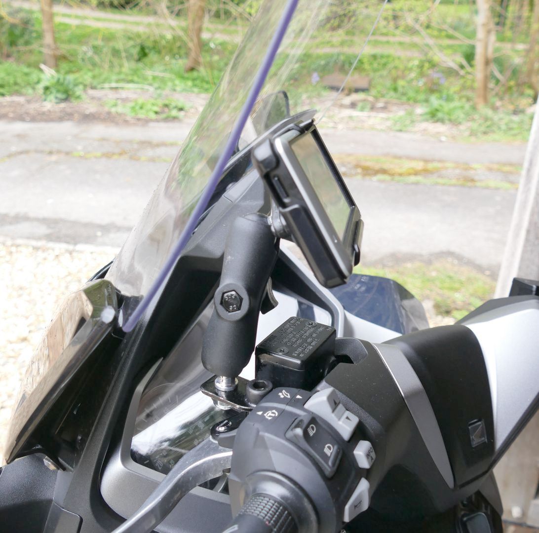

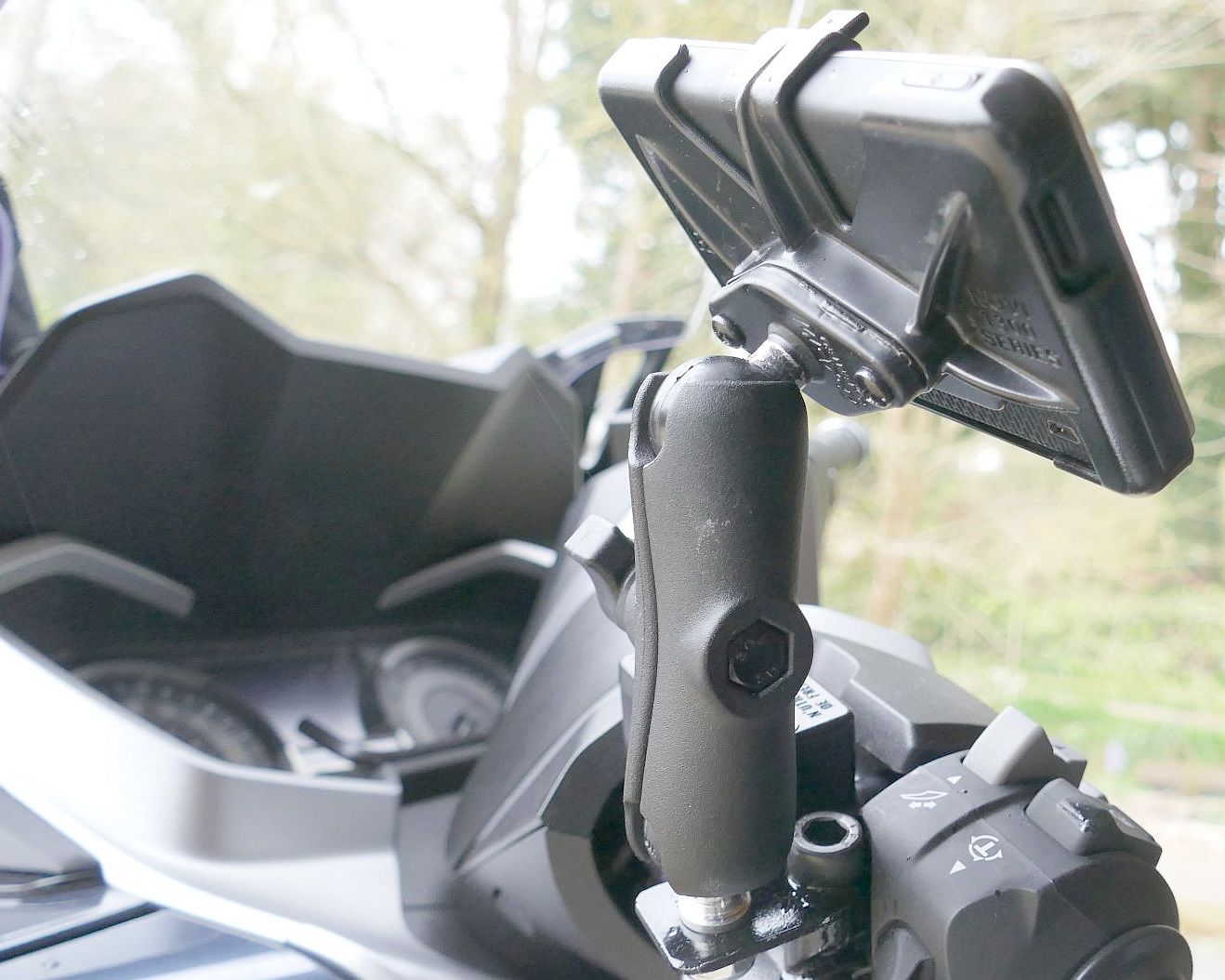

Hi there,
I have mounted my RAM mount to the rear brake reservoir. (or rather Honda did!) they didn't drill any new holes, they just used the two holes at the front of the RAM bracket to secure. My old TomTom was fairly heavy and it stayed secure on there no bother, no leaks from the reservoir that some people have suggested.

Thanks Oldie, location updated. So I got all my connections ready, found the battery, took one look at the transformer that came with the Garmin and though forget it, its it's not going to be hardwired
The cradle has been modified so I can use the mini USB into the 12v instead.

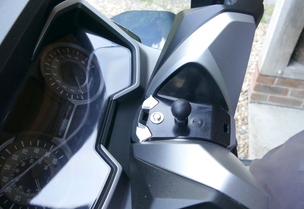

Plastic cover is removable in the middle.There is a 6mm tread. RAP-B-379-M616 from Ram mount will fit.

I too fitted the said ram mount the right code too but upon screwing into the left mirror blank hole it stops like the thread is wrong.
magpiemale
Posts: 16
Joined: Sun Jun 14, 2020 8:51 am
Re: GPS Mount for new Forza 300??
Post by magpiemale »
Up date the ball stud was wrong thread 1.5 pitch not 1.25 as should be sending it back packaging was correct but item wasn't either the seller or ram mounts messed up

Rollmops !
What is the size of your makeshift bracket for 1 inch ball stud 25mm by 30 mm ?
