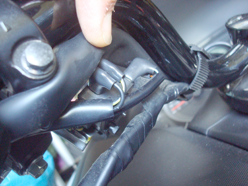

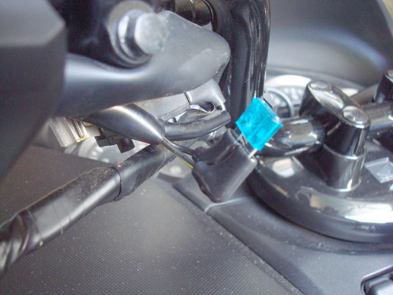

It is a subject well debated whether to bypass the brake lever switch to allow the bike to start without pulling hard on the left brake lever. My view is that if the engine were to stall whilst in a moving queue of traffic I would prefer to just hit the button to restart rather than come to a dead stop. Another view is that if the engine were to start with a wide open throttle and no brake the bike would take off, ( I will risk this as not very likely). So I decided to bypass the switch and 5 minutes later it was done!....here's how I did it....
Find the switch connected to the left brake lever, there are 4 wires plugged into it. Pull off the pair which are black and black/yellow. Take a small mini fuse and insert the fuse blades into each of the wire connectors. Wrap neatly with insulation tape and tuck the wires back approximately where they were. There are so many wires and cables there they are easily hidden. And that's all there is to it.

When the starter inhibit switch failed on mine, as a stop-gap while I waited delivery of yet another new switch, I cut a paperclip to a suitable length, bent it into a U-shape, inserted each leg of the U into the wire female connectors between the metal and the protective coverings then carefully pushed them both together back onto the switch male connectors.
Think I had three left side brake/starter inhibit switches fail.
