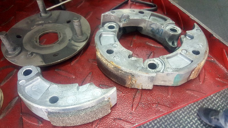

So finally with all the Covid-19 lockdown here in Phuket, I managed to go and change the clutch bell and clutch shoes to new grooved and carbon I bought from Lazada. I went to a repair shop opposite big Honda, and he did a very good job, cleaned and greased everything, spend a lot of time and charged me a very reasonable rate - Honda will never see me again...lol
He also said to change the shoes better also change 3 small graphite washers, they got them from Honda across the street, cost nothing, like 120 baht or US$4 for 3...
My old clutch shoes were now almost worn out completely (at 11.5k km ! ) and I noticed worn unevenly - which was not before, I think the uneven wearing maybe to do with sandpaper we did last time... !
I also used the opportunity to change my rollers to a bit lighter for maybe a bit more acceleration. I couldn't find a shop here that had the weight I wanted in stock (18g), and deliveries are slow these days. But I found out Xmax original rollers are exactly the same dimension as Forza but are 17 grams, as oppose to Forza 21g. So I went to Yamaha shop and bought 3 x 17g and mixed with 3 x 21g of mine - I thought 6x17g would be a bit too light...
So now my effective weight is 19g, so far it's okay, a bit higher RPM, maybe about 500rpm more at various speeds, need to ride more to get the feel for it, but it's not a big difference, and I didn't want a big difference, so it's okay...
Clutch is very smooth as well of course, but let's see how long that last...
