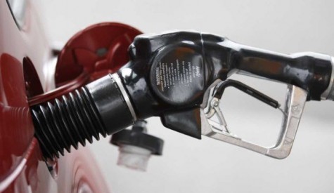

Does the gas pump handle look like this?

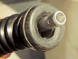

If the pump has the black accordion piping on the spout, you will have difficulties. The black part of the nozzle has to be compressed before the pump will work. The neck on your gas tank is too short to compress it sufficiently.
Either you need to pull back the accordion with one hand, and pull the trigger with the other, or get a short piece of PVC pipe to put on top of your gas tank opening which in effect lengthens the neck of your gas tank, and allow the pump to work.
I pull back with the left hand while the right pulls the trigger SLOWLY. I put the nozzle in as far as it will go.

Those nozzles are definitely different to the UK

This type nozzle is mostly used in large urban areas for pollution control. The outer black housing is supposed to suck gasoline fumes back into the pump rather than let them escape into the air. There are lingering questions whether they have any value, and rumors suggest they will be phased out. We'll see...
They are easy to use on a typical car with a sufficiently long throat on the gas tank. But just like the short neck on the PCX, filling a portable gas can is a chore. If you push the nose in far enough into the can for the fuel to flow, the nose will be so far down in the can that it will only half fill before shutting off. Again, you gotta pull back on the black sleeve whilst pulling the trigger, or the gas won't flow.
None of us said we loved these things, although it is a less smelly job filling your car.

We don't have that type of nozzle in Georgia, ours are much simpler looking -- no accordion sheath thing.

In California ALL of the gas pumps have that accordion like filler top. All of us out here when filling our motorcycles are accustomed to holding back that accordion thingie (a highly technical term) with our fingers.
But be careful since it kinda disables the automatic shut off.
