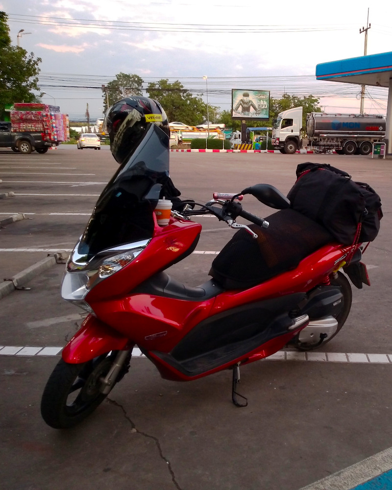

I'm the proud owner of a 34,000km 2012 PCX150 and a long time lurker on the PCX Forum. I bought my bike from a friend at 12,000km. Recently I was thinking of selling her but decided that the Honda reliability combined with extra performance from simple mods makes her a keeper. Her name is Miss Melling (in memory of my friend who was the original owner and who passed away last year.)
I live in Bangkok, Thailand where the first run of PCX's was made (they are now made in Indonesia). Parts and accessories are very inexpensive and I enjoy making mods to the bike. After a one day, 500 mile run a few weeks ago, I'm so impressed with the PCX I've decided to give her the attention she deserves.
Here she is at 6.30am at fuel stop No.2 on that long ride. I needed a strong, hot coffee after a 3.15am departure.
Last week I had a complete set of new steering bearings fitted by Honda mechanics. While the front end was apart I fitted YSS fork valves. In Thailand, the mechanics are quite happy to have you work alongside on the bike while it's stripped down. Which is just as well since I have tools for most jobs but not a work space.
Now the steering feels lighter and much better damped. The bruise on my right palm has healed. (The road surface in Bangkok is very poor in places. Rough, high transitions from one section to another are commonplace, as are metal road fittings which jut above the road surface.) The YSS fork valves give better control and attenuate violent jolts successfully.
The most significant performance modification has been the YSS rear shocks. Previously the longest journey I would attempt was about 200km. Cruising speed would be 90 to 95kmh. Any faster and the bike felt uncomfortable and unstable.
The new YSS Gazi shocks have raised the comfortable cruising speed of the bike to 115kmh. For overtaking, 120kmh is possible. Top speed (downhill) has been 125kmh on the clock.
Having ridden quite a number of motorcycles in the past, my goal with the PCX is to make cruising at 120kmh comfortable. This would make the bike suitable for most journeys in Thailand. Traffic on the larger roads around Bangkok is 90-110kmh. The PCX loses out above 100kmh to faster accelerating cars. But I have to say it performs much better than I would anticipate.
