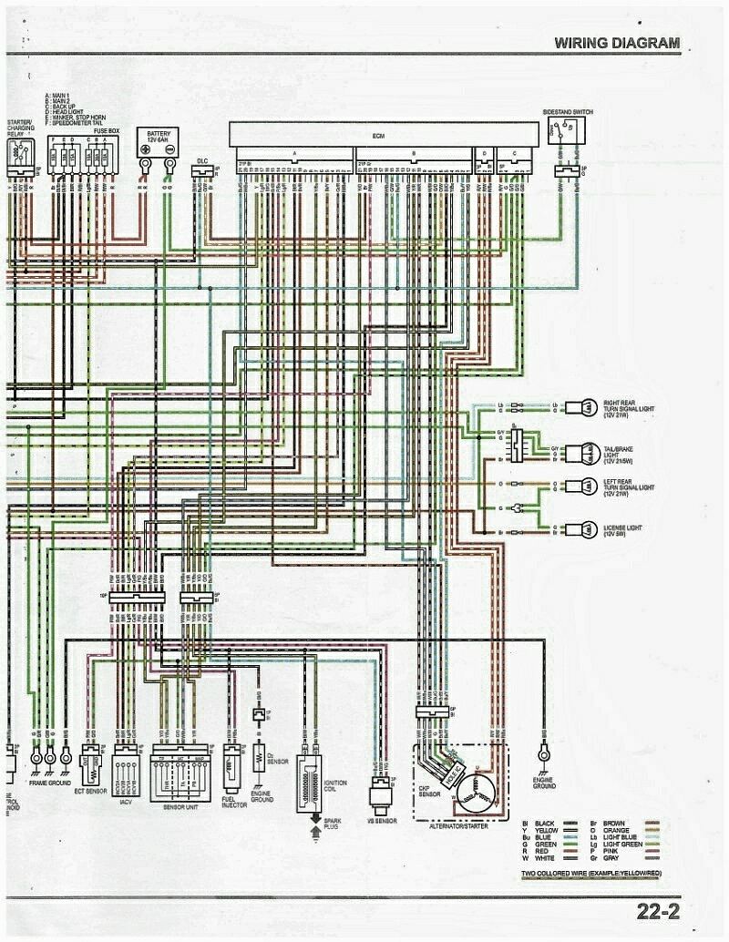

Re: got pcx150 today was wrecked need help
Memturbo, do you need a wiring diagram? This might help some....I hope.

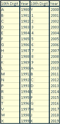

1st, Let's figure out When she was Born. You're guessing 2013? You may be right.
Click below link - to find Vin # - then decode Vin# (digit 10 = year of manufacture)
https://www.1aauto.com/content/articles ... r-decoding
NOTE: This too From their website. Ya'll can print it - wallet size chart 8)

I was looking at the diagram today and noticed that the blue/green wire from the ECU pin 14 goes to several different sensors including sidestand switch, fuel level
sensor,speed sensor,and the DLC plug . Given the fact my fuel level is flashing and I don't seem to have a speedometer showing mph when spinning the rear wheel with
a drill,Is there any way the fact the fuel gauge is flashing but I have a full tank of gas have anything to do with it not starting?
Like it wont start if no fuel or bad speed sensor?

I never tried the right brake for starting, but according to the first PDF I posted, the two are wired in parallel, as you have discovered by observation. Eitherr should work, and i will test that out at my earliest convenience. Assuming I can hold the thought.
My guess is that the blue-green wire is a sort of ECM specific common ground that lets the controller know that all the switches are in a "happy" state. I don't know what to make of that or how it may help, but it could be important.

News ! I took the blue-green wire and connected it to ground and the engine turned over!! but it blew a main fuse
I dont know if this could be a "floating" ground or just sensor dependent ground either way I was able to turn over the engine
Any help by anyone that know about this please help Im getting closer
