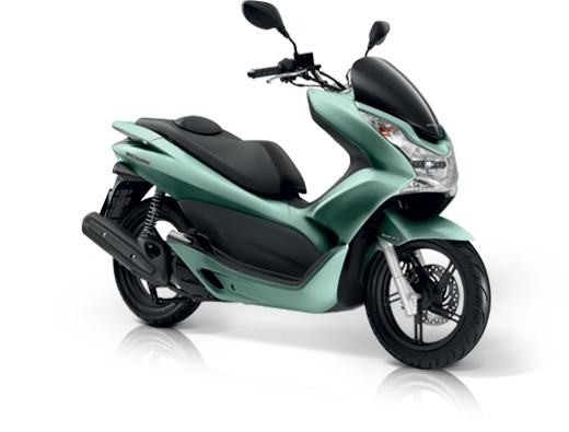

Petrol blue metallic
Re: Identifying what model of PCX125
^^ Ouuu...I'm liking that New color. Is it me or does it look more like a Light Sage green or Mint instead of a Blue? Does anyone know If this color is coming to the US?
