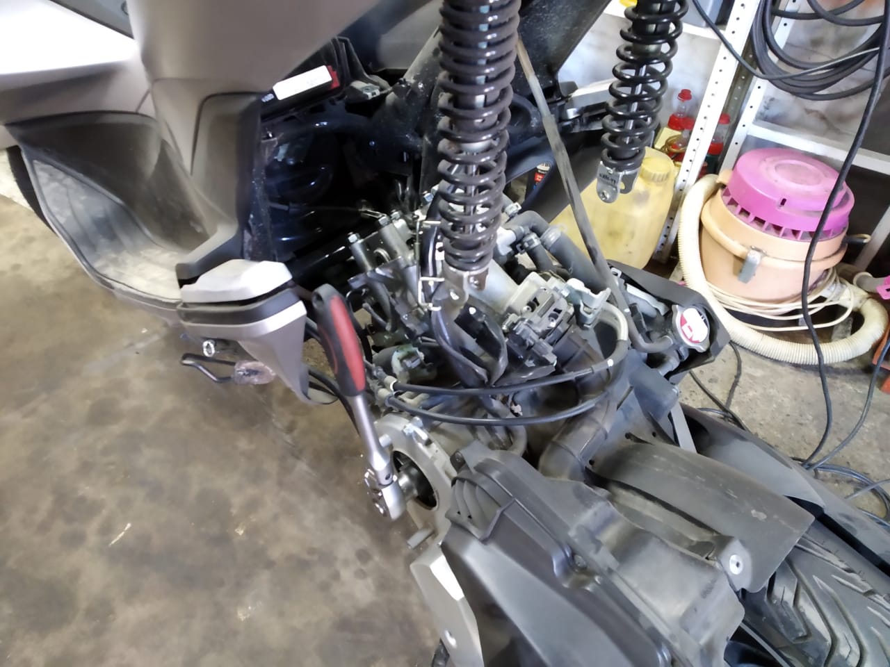

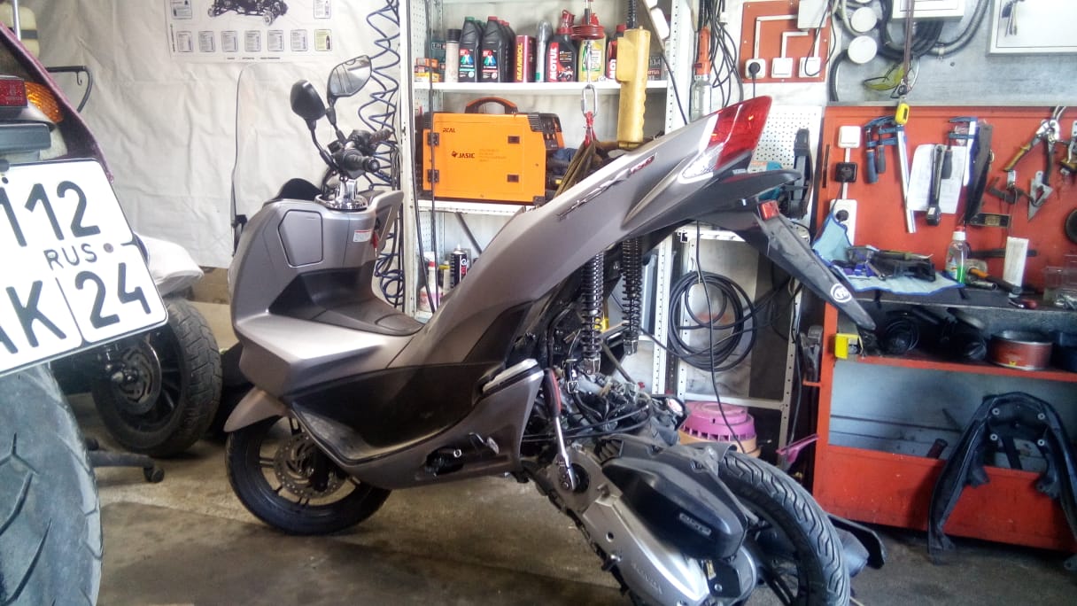

Re: 2019 PCX150 600-mile valve clearances
You know I'm late to this party but WOW! YES someone has managed to get to the valve clearance adjustment on the old models without following the SM at all. That's truly ingenious and certainly we want TO DO THAT! over taking all the plastic off. Do my eyes deceive me? Is this real? is that an LED PCX?
