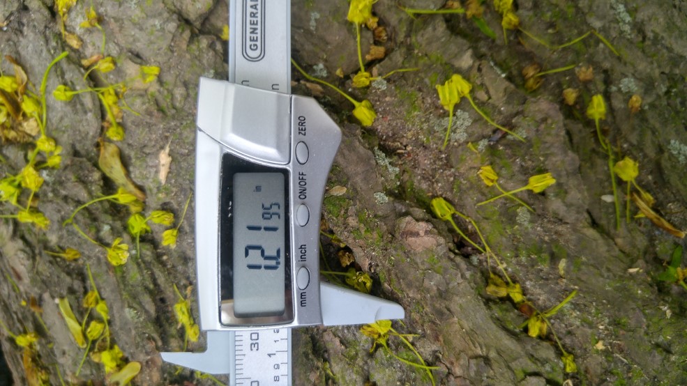

So in trying to search for replacement/upgrade options I've run into the difficulty of getting the specs for the upper front staunchion diameter ie inner fork tube diameter. As I'm considering for the first phase to upgrade to forks from one of the later model 150's - dependent upon fitment size of course.
I'd be interested in hearing about anybody else's experiences with retrofitment of later model forks into an early model and the problems you encountered.
But what I'm desperate for is for peeps to put a vernier over the forks of your own upper fork tube and post a reply with the model serial number and diameter size so I can cross reference of the YSS catalog or the Honda parts catalog and narrow down my choices.

Re: Front fork specs
On my 2013 the upper tube measures around 1.219-1.221 inches (30.96 mm or so). Take it with a bit of salt - It is hard to be sure that caliper hasn't changed while I removed it to read.
- Upper Fork Measurement.jpg (168.23 KiB) Viewed 7038 times
