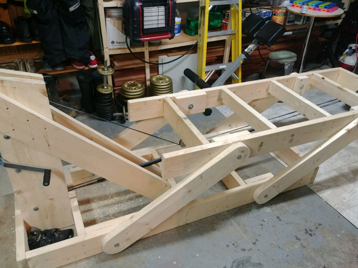

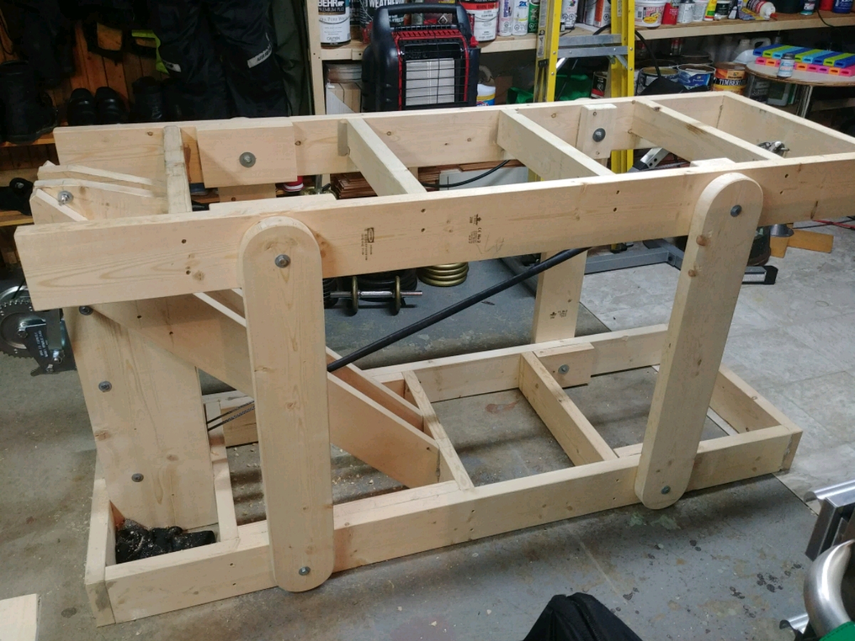

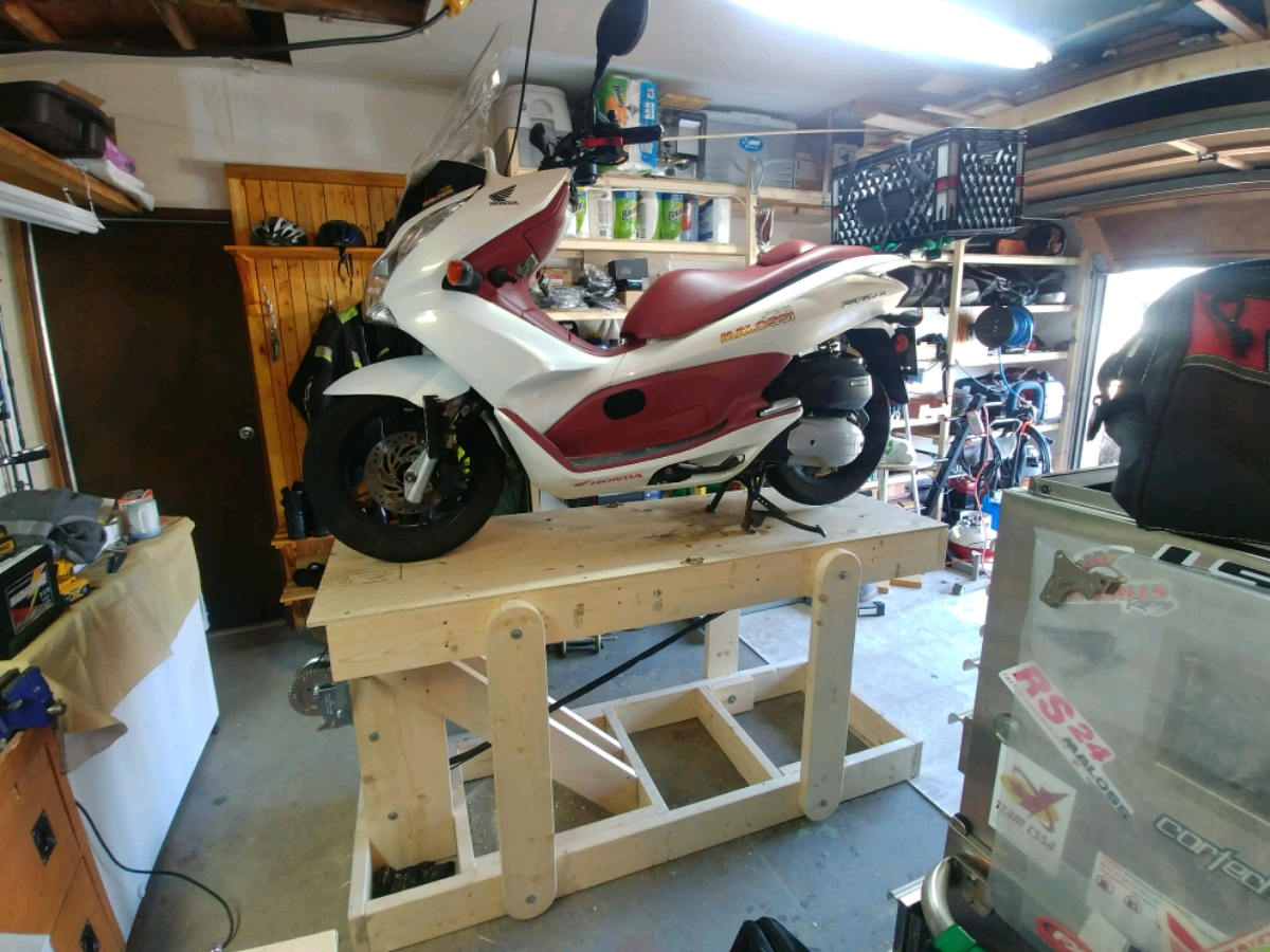

I have grown tired of rolling on the ground to service my scooter so I designed a custom lift based upon my needs.
It can be adjusted to any height if desired.
I have two scoots now, a 2013 with 47,000km on it (bought it new) and a 2015 with 3000km. The first one is due for brakes, brake fluid flush, and a good detailing of the drive system. So this summer it gets worked on as I ride the 2015.
When not in use as a lift, it makes a great workbench so it is usefull for other things.
Below is a link of the lift in action.
Ignore the plump guy, he was just a stand in while I made the video. :lol:
https://youtu.be/IV05IExT9Ac

Brilliant! :D
Great idea to use a boat trailer winch. . ..
It really is a lot easier working on a bike/scooter higher off the ground. My 1500 lb. store bought lift doesn't go that high but it's just enough to remove/replace wheels.
Just curious if you use a ramp to load and unload the scoot off your lift. :geek:

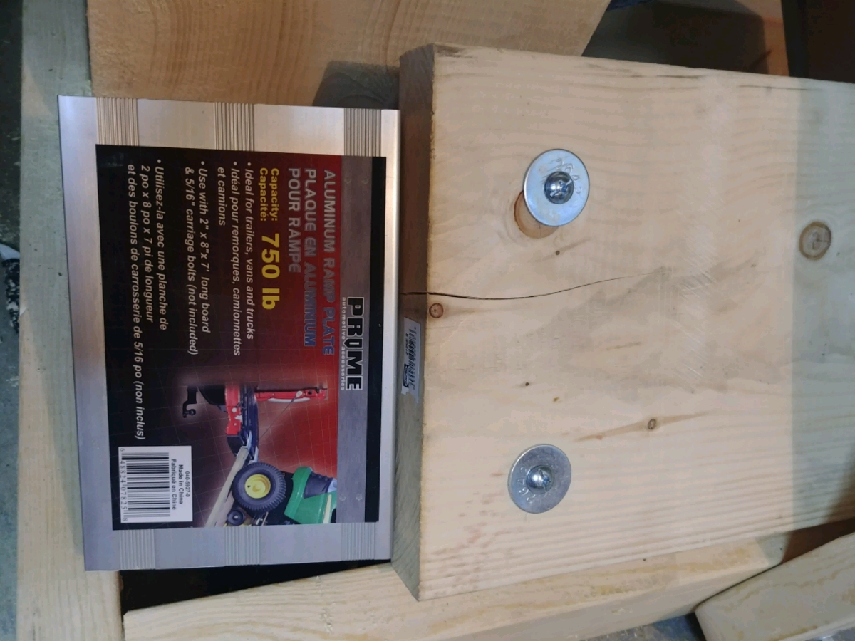

Forgot the ramp, its a 2 x 10 plank thats 6ft long so it fits under the table when not in use. Nice easy grade to roll the bike up on.

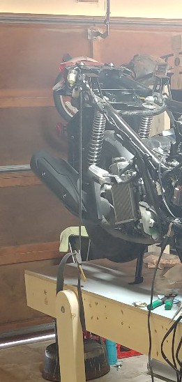

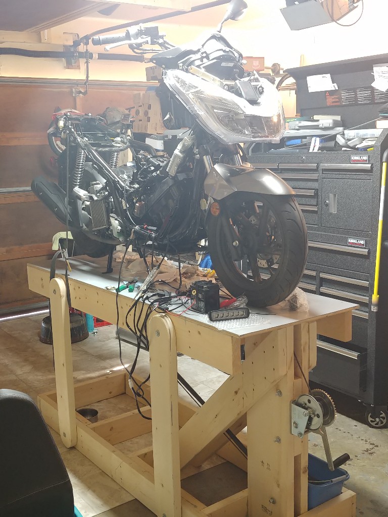

First time really using my bike lift. Getting the pajamas off the 2015 pcx was interesting to say the least.
Checked the valves, too tight so adjusted. Changed oil and final drive. Now installing driving lights. Thats the reason for all the plastics off. I want to tie into the switched ignition. Only 3100km on her, cant wait to get it on the road.

MikeP, that is very cool. I like that a lot. A suggestion, for securing the bike and to avoid any unfortunate mishaps would be to install some eyes or hooks and use tie downs to secure the scooter in place.
Re: Bike Lift for ease of maintenance
honkerman wrote:MikeP, that is very cool. I like that a lot. A suggestion, for securing the bike and to avoid any unfortunate mishaps would be to install some eyes or hooks and use tie downs to secure the scooter in place.
It is tied down isn’t it.

Thanks for the tip honkerman. It is tied down across the back end, but I agree 2 straps tied to hooks would be better.
you you, you have a good eye for detail.

Ah hah! That strap blended in to my eye. Good that you did that though.
