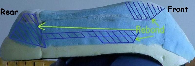

Try http://www.foambymail.com for the proper seating foam.
Explains foam for DIYing.....
I rebuilt my Kymco seat using 2 types of their foam. 6 years on the rebuilt seat shape and cover (by sailrite) still look and feel as new. Thin Kymco seat had a horrid banana sized lump is plastic seat pan at your tailbone.
Yeah, stay away from JoannFabric stores....wrong stuff for riding purposes.
Used firmer 'rebond' foam beneath the blue foam for structure.
