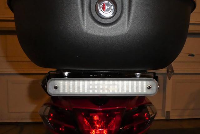

Did not have to drill the case to mount the light bar - used the 2 rear case mounting screws for that.

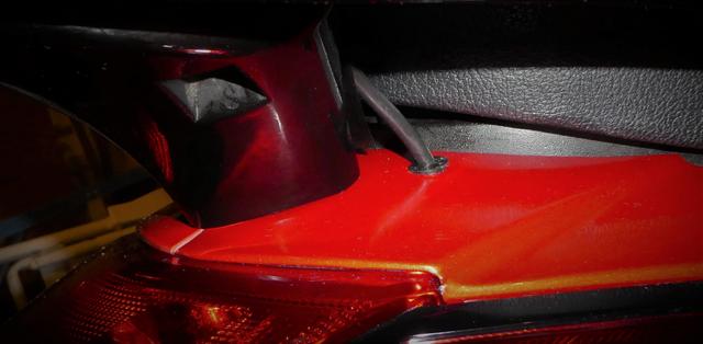

Drilled the body to the side furthest away from where my posi things were and where the big plug was.....more room for safely drilling on the off-side. Fished the wire thru a rubber grommet to waterproof the hole in the scooter body.
Very bright light bar, of course. (the Liberty has good rear turn signals - so did not wire the light bar for turn indicators) - just DRL and pulsing-to-steady brake light)

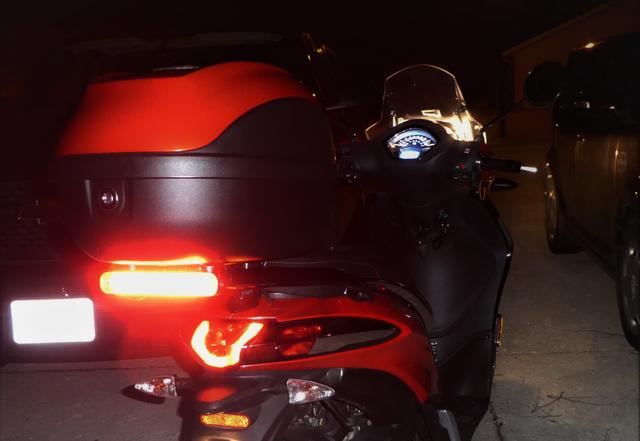

Rear running lights... (added a pair of LEDs in the scooter taillight earlier today)
Apply the brakes > the whole world lights up back there (3 more bulbs + the light bar)!
