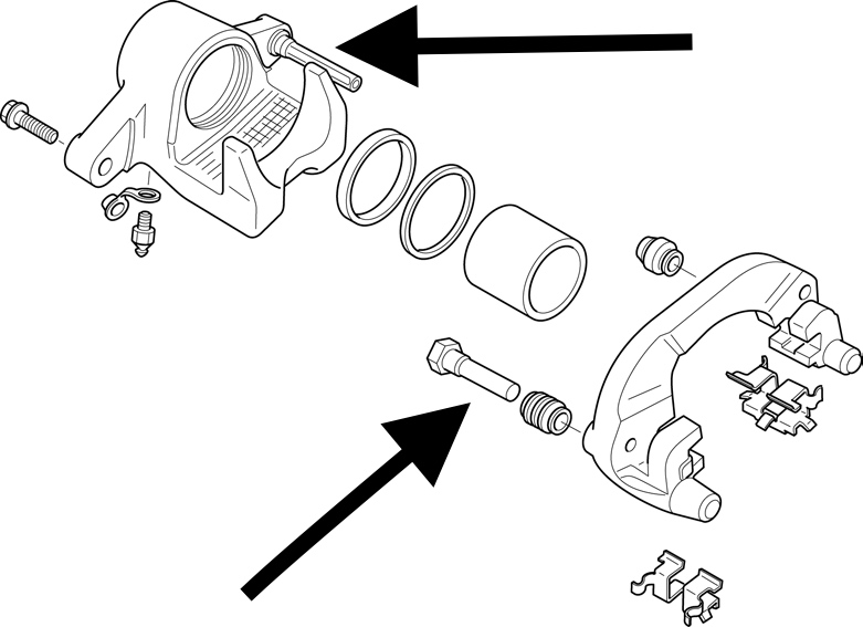

You do not need any grease on the clips.
It is needed on the pins that connect the inside and outside of the caliper. One end of the pins have a rubber bellows to hold the grease in. I think Honda never put any grease in there at the factory. 5 cents worth of grease. Damn it, Honda!
The big arrows point to where you need to add some brake grease.

Thanks for the info, I thought you greased those clips/guides at bottom right of your image, that's where the pads sit - and I guess move (!?), I thought that is where it gets stuck, perhaps also due to deformation and/or dirt there ... !?
By the way, I checked to buy new ones of those two clips, but Honda does not sell them separately, it's part of that back side of caliper body....!!!!! Very odd . Part number 43110-KVZ-631, and it's $85 from some sites...., pricey.
The mechanic did open and grease those pins, one of the rubber boots weren't fitting well, I asked him to push it in and make sure it sits well. So that should be okay really...
Maybe it's my piston or brake line...!? I'm well pissed off, need to fix this, pads are cheap here to replace but I don't like it creating heat and degrading performance..., I chat with Honda mechanic too yesterday, he just dismissed it as , yeah, no problem , it's same on all Forza, just need to replace pads often... !!! I can't believe these people , just don't understand it's not okay to have brake pads sticking like that...!
So no grease in those clips/guides...!? So the mechanic was right when I asked him to do that and he said not a good idea...

Did they put proper hi-temperature brake grease in there or just cheap axle grease?
I got 100,000 km on the front pads and they could have lasted even longer.
The rears do not last very long, about 15,000 km.

No idea really, this is Thailand so they just grab whatever grease is close at hand...!
I think I'm going back there for more investigation of brake caliper and also show him the mess he made on my side panel paint, see what they can do...
