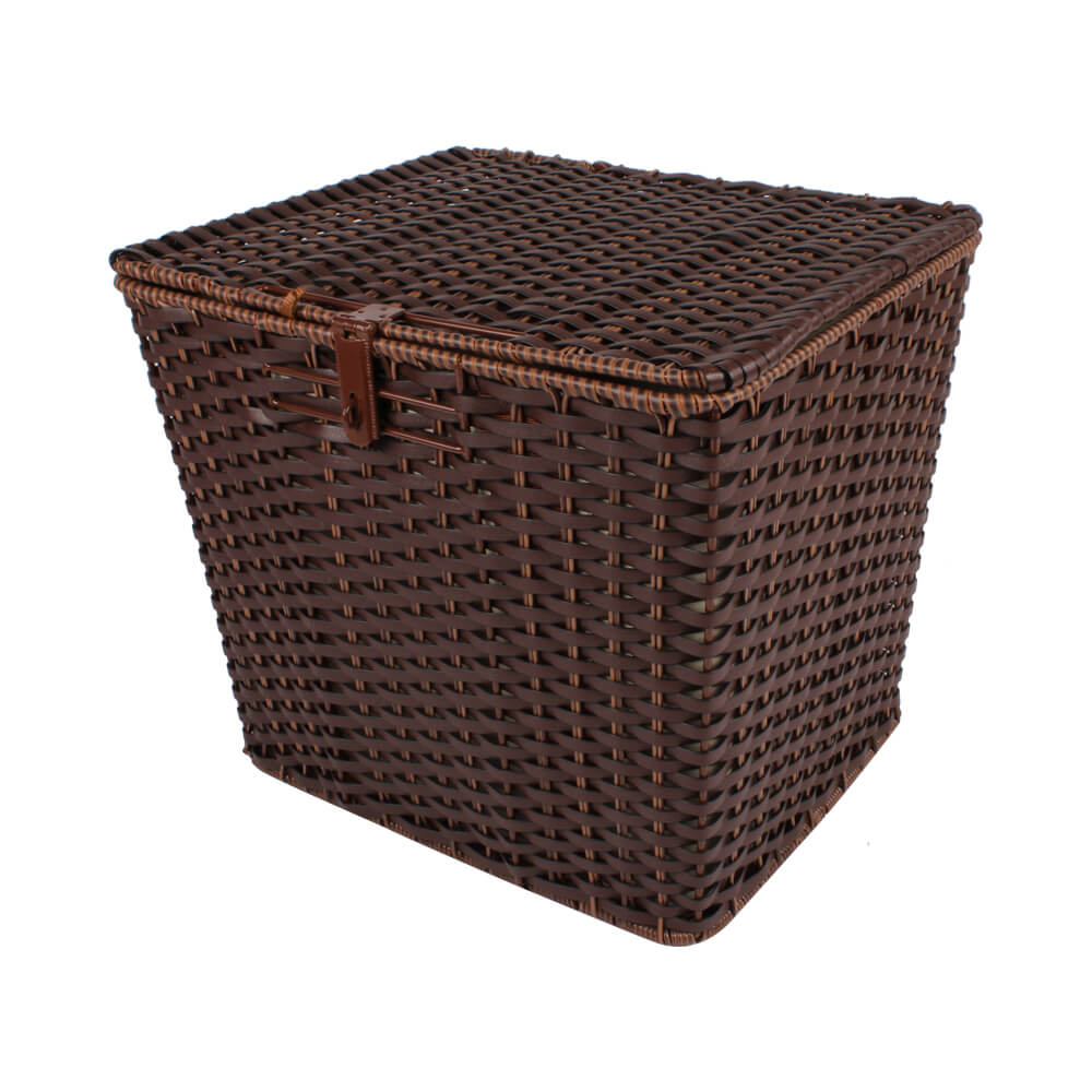

We put the basket on the rear of our scooters so's when the snake gets out it don't slither tween ye jewels.
